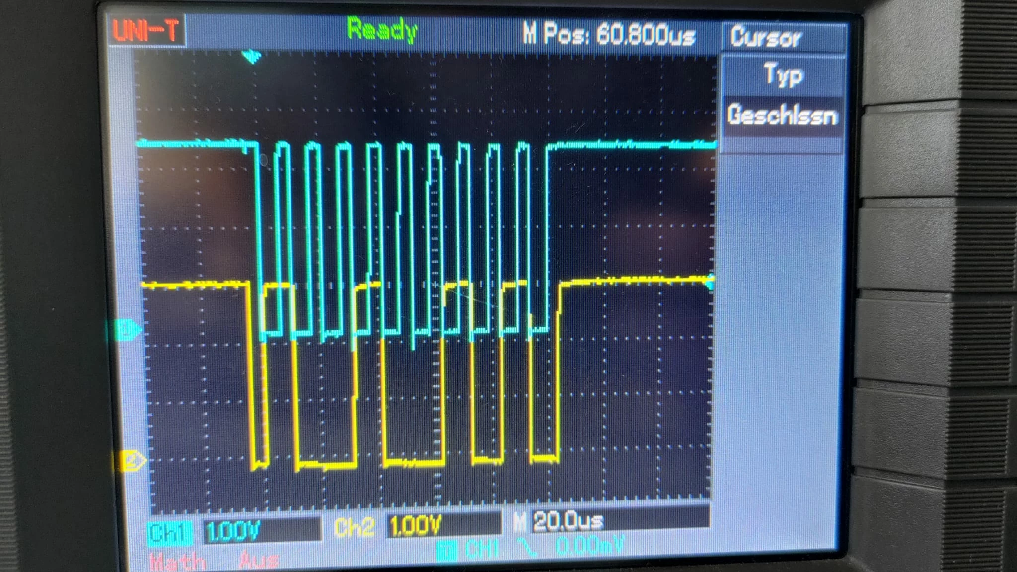

I have an STM32H503RB (NUCLEO-H503RB) trying to read out some I2C slave devices. It actually works only for one of the devices. This tells me, that the I2C bus is somehow working correctly.
But for the remaining three IC (Temperature, GPIO & ADC), there is no way for me to even send the register address.
Right after the Device address, the communication ends. See the attached file. This is the communication to an MCP9801T temperature sensor (device address [W] = 0x92).
I actually don't understand the reason, why this happens.
f=100kHz
What I did:
- changing pull-ups: same behaviour for 4.7kOhm & 3.0 kOhm
- soldering the device on an otherwise empty PCB: only the 100nF, the pull-ups and the MCP9801T is there.
- I2C-Deinit as well as I2C-Init.
The source code is as simple as that:
while (1)
 data[0]=0x00; data[1]=0x01;
 HAL_I2C_Master_Transmit(&hi2c1, Temp_ADDR_W, &data, 2, 10);
 HAL_Delay(1000);
Has anyone at least an idea where to look at? Of course, let me know, what information you are missing.

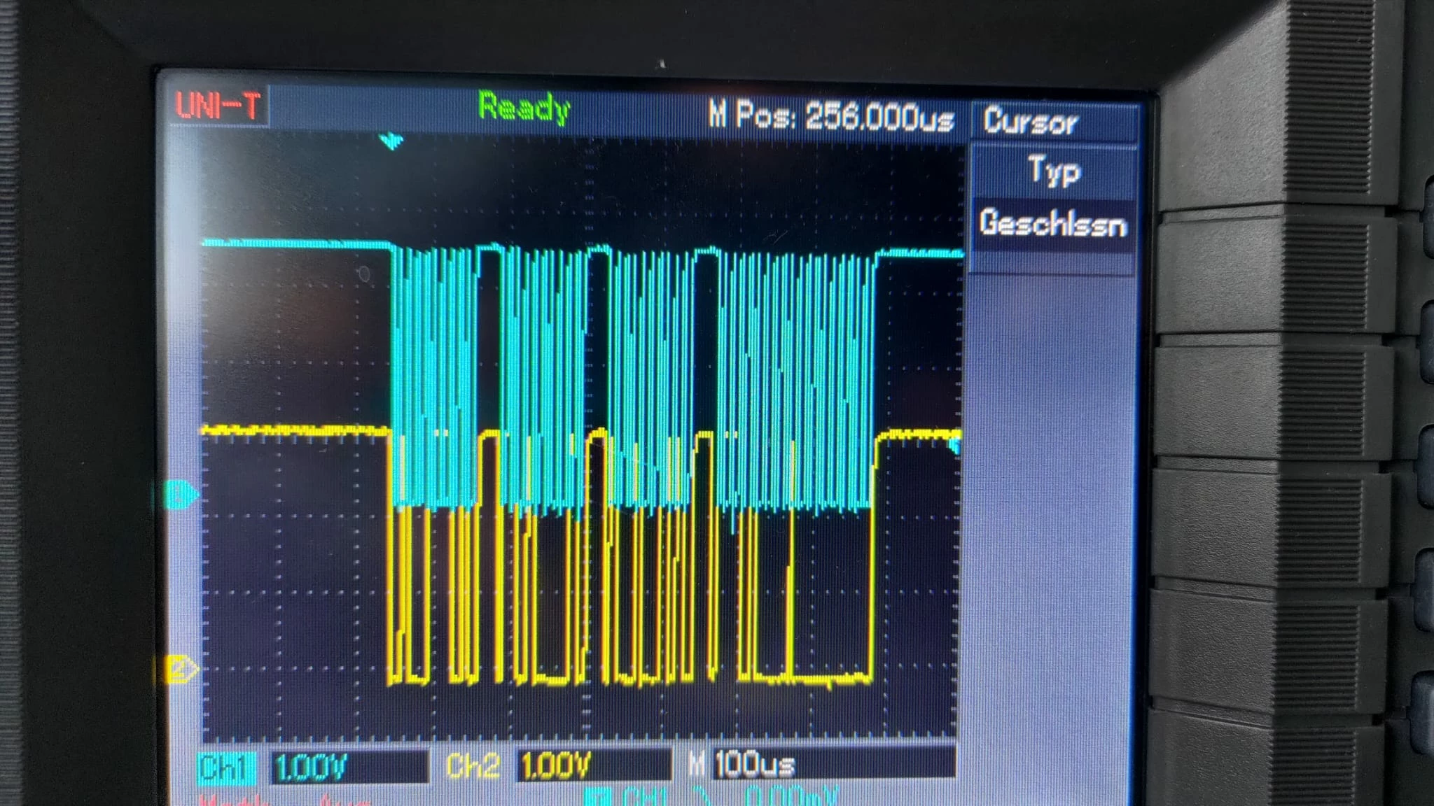

Here is the picture of addressing all 4 ICs one after each other:
while (1){
 data[0]=0x00;// data[1]=0x01;
 HAL_I2C_Master_Transmit(&hi2c1, GPIO_ADDR_W, &data[0], 1, 10);
 HAL_I2C_Master_Transmit(&hi2c1, ADC_ADDR_W, &data[0], 1, 10);
 HAL_I2C_Master_Transmit(&hi2c1, Temp_ADDR_W, &data[0], 1, 10);
 HAL_I2C_Master_Transmit(&hi2c1, LED_DRV_ADDR_W, &data[0], 1, 10);
 HAL_Delay(1000);

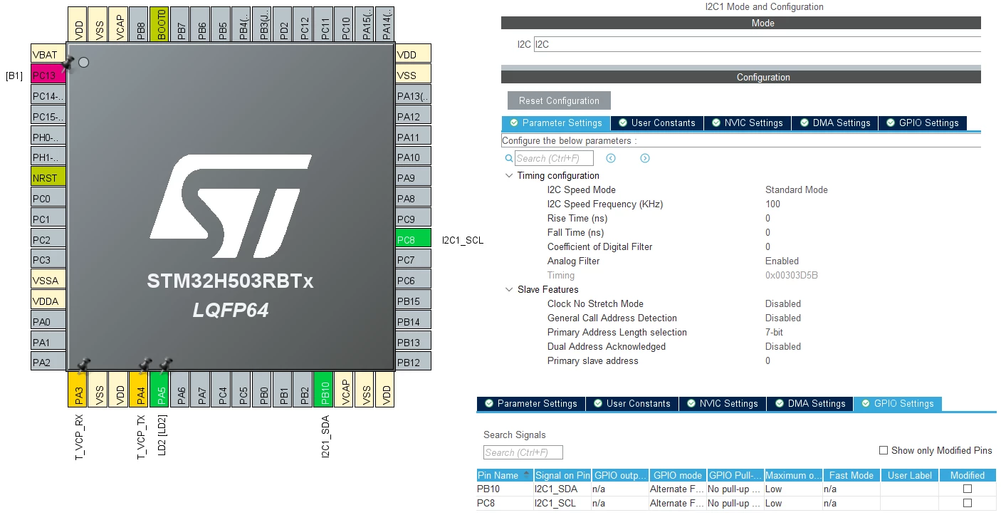

This is my I2C configuration:
Thanks again for your help!

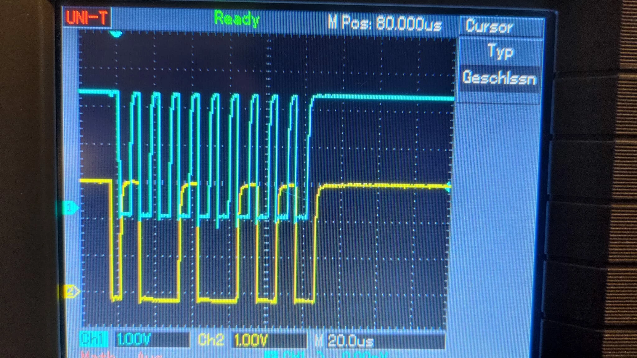

I have changed HAL_I2C_Master_Transmit now to Mem_write:
uint8_t reg_addr = 0x00;
uint8_t data16[] = {0,0};
while (1){
 HAL_I2C_Mem_Write(&hi2c1,Temp_ADDR_W, &reg_addr,I2C_MEMADD_SIZE_8BIT, data16,2,10);
 HAL_Delay(1000);
 The result remains disappointing:
What I tried additionally:
- changing to 400kHz: no improvement
- changing to 50kHz: no improvement
- adding an I2C sensor that I successfully used in the past with another microcontroller which has Pull-ups of 1kOhm soldered next to it. This sensor cannot be addressed as well. Same picture on the oscilloscope.
- with these 1kOhm-Pull-ups I tried to access the 4 other Slaves: picture unchanged: GPIO, ADC & Temp failed, LED-DRV still possible to send the address byte.
Best regards
enbwAuthorBest answer
Jan 23, 2025 11:30 AM UTC
Who is betting that the mistake is a *** one? :)
This is how I continued:
- I connected the additional sensor, that once was working as a single device without the PCB with the others. It was working.
- so i kept the wiring as much as I could as it is: just adding some cable who forward the signals and power to the PCB: the GPIO, ADC & Temp were responding! Yeah.
Mistake: I mixed up SDA & SCL  and connected them vice versa... :\
Why was the LED-Driver still working? Because I also mixed up these two signals at its pins. Two errors sometimes equal out and create some confusion.
Ok, so I identified it now. Thank you very much for your assistance during the debugging! :)
