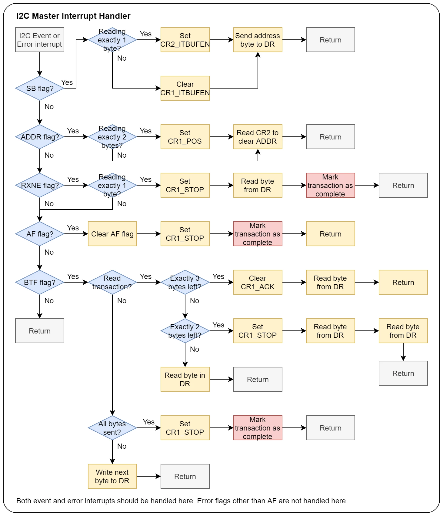

I2c Restart on STM32L using Standard Peripheral Library (not HAL)
I've been using an STM32L151 for a number of years...long enough ago that the firmware I wrote uses the SPL, not HAL, and I'm really not interested in re-writing the firmware!
My problem is that a new I2c device I am connecting requires a RESTART between writing a command and reading the data.  I have seen this problem from HAL users, and they are told to use the memory access routines rather than the standard routines.  There are no such things in the SPL.
I have removed the call to I2C_GenerateSTOP following the transmission of the command, but now I get an interrupt that says there was no ACK.
Can anyone either make a suggestion, or point me to some example code?  I guess I should say that I am using a real-time OS with devices working with interrupts, so code or suggestions that say "loop until bit x is set" don't help too much unless bit x being set can generate an interrupt.
Thanks!

From experience, the I2C peripheral is extremely complicated on the STM32F4 series and writing an interrupt handler to handle every situation requires some skill. By comparison, the STM32H7 has a much easier to work with peripheral.
The STM32L1 series looks to have the same peripheral as the STM32F4, except it's missing the FLTR register. Perhaps it's slightly different, but it looks pretty similar so the below should help.
This is a flowchart for how to write the event handler you're looking for on the STM32F4 and will likely be similar for you.
The code you posted has multiple bugs associated in it, but if you follow the flowchart to correct it, it should work. Good luck.

TDKBest answer
Nov 28, 2023 5:34 PM UTC
BurnsAuthor
Dec 2, 2023 6:11 PM UTC
I have solved my problem, not exactly by following the chart to the code specified, but the code and chart did help me to better understand how the peripherals work.  The fix can be described in the chart, or in my code.  In both cases, there is a read transaction going on and there are exactly three bytes left when the BTF flag is set (line 68 in my code).  The event chart shows that one should clear CR1_ACK and then read a byte from the DR.  This is what "my" code did.  But what I had to do was add a call to I2C_NACKPositionConfig(I2C1, I2C_NACKPosition_Current ), which essentially clears CR1_POS.  I'm not entirely sure why it was not clear in the first place (as the chart clearly assumes) but that made the difference.  It appears that it should have been set in this code only if there were exactly two bytes to receive.  Perhaps it was left set by a previous 2-byte transaction (in which case, the chart really should do it as well).
It appears to me that there are a couple difference between the STM32F and STM32L...at least the documentation seemed to imply a few differences from what the chart does.  But in any case, I did not want to re-write the entire driver (since someone else "owns" it) but this change fixes the problem.
Thanks for all your help.  I'll mark the chart as "accept as solution" to get it off your books; besides, it was really helpful if not the exactly solution.
