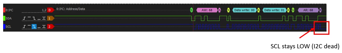

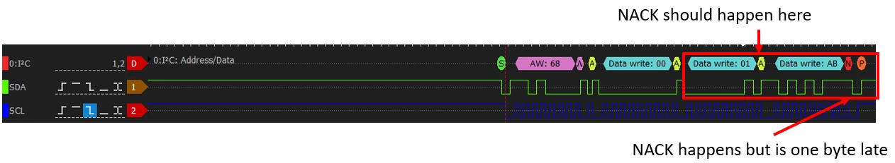

For a Host-Write to the MCU slave, this approach works fine except that the NACK is received by the host one byte late (see screenshot). This solution is not very clean and not preferred by us.STM_Forum_SBC_Logic_Analyzer_Write_NACK_description.pngFor a Host-Read, this approach does not work. A NACK is never received by the host and the SCL line stays low afterwards, effectively having killed the I2C connection (see screenshot).STM_Forum_SBC_Logic_Analyzer_Read_Kill_description.png
