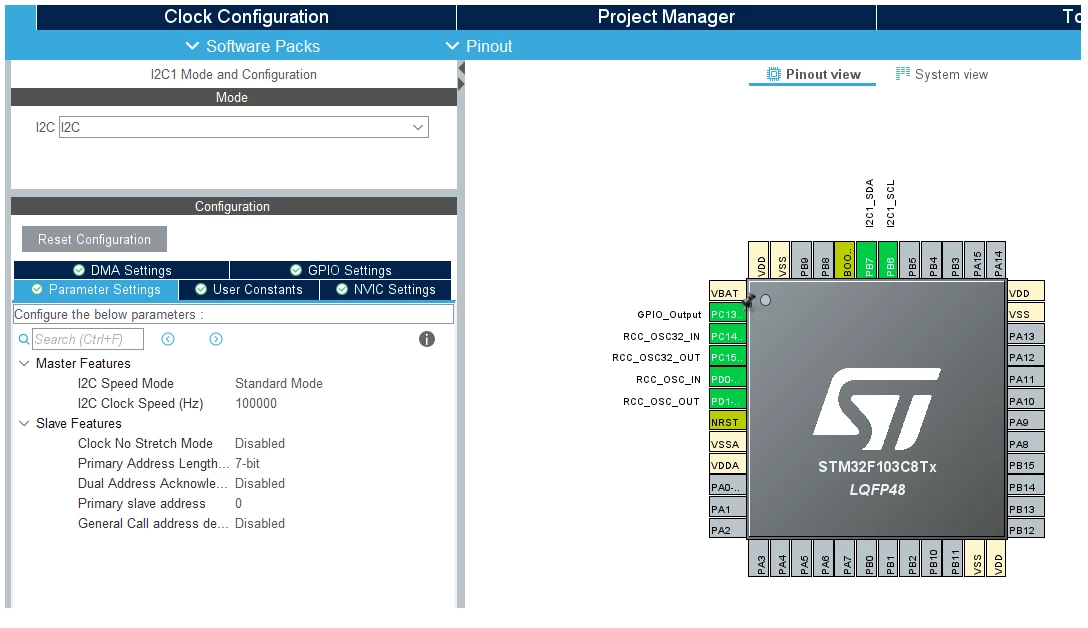

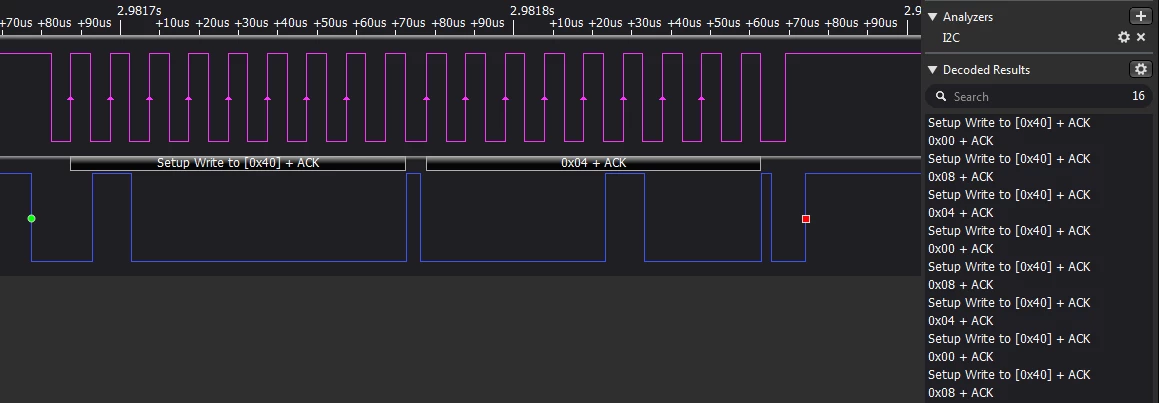

I tried to send data (count from 13 to 15 every 500ms) thru i2c1 using HAL_I2C_Master_Transmit.
slave is pcf8574, scl & sda line pulled up with 3k3 resistor.
usb scope shows master send correct address, but data always incorrect (which is either 0x, 4x or 8x).

I tried similar code on STM32F051 and STM32F407, the result are same.
any tips to troubleshoot this issue ?

Isn't the data passed as a pointer, not by value?
S.Ma
Principal
Aug 10, 2022 3:04 AM UTC
From
HAL_I2C_Master_Transmit(&hi2c1, 32<<1, buf[10],1,100
To
HAL_I2C_Master_Transmit(&hi2c1, 32<<1, &buf[0],1,100
LCE
Principal III
Aug 10, 2022 10:36 AM UTC
I guess he only wants to send buf[10] = 13, so:
HAL_I2C_Master_Transmit(&hi2c1, 32<<1, &buf[10],1,100);
