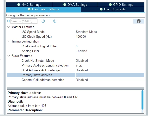

I am trying do a loopback test, i.e I2C1 as master and I2C2 as slave on the same board(STM32F429ZI DISC1).
I am giving the address for slave as 0x42 left shifted by one, and storing the same in oar1 register for I2C2. Now the problem is the master is not getting acknowledgement from the slave. I am using HAL to test this.
I have also turned on/set the pull up and open drain for both the I2Cs. And i have also tried with external 4.7k ohm resistors, for the pull up resistance. But to no avail.
Can somebody please suggest what can i do.
Best answer by KnarfB
the I2C2 slave address is not set here?

Thank you, But i am using only one board...
I will try again with non blocking functions.
Let me add the main part of the code.

KnarfB
July 15, 2025
You are using the blocking functions which cannot work. When HAL_I2C_Master_Transmit returns, all bits were already sent out on the wires and are gone.
Try:
 uint8_t txData = 0x69;
 uint8_t rxData;
 while (1) {
 // prepare Slave Receive
 if (HAL_I2C_Slave_Receive_IT(&hi2c2, &rxData, 1) != HAL_OK) {
 // Handle error
 // Master Transmit
 if (HAL_I2C_Master_Transmit(&hi2c1, 0x42 << 1, &txData, 1, HAL_MAX_DELAY) != HAL_OK) {
 // Handle error
 // Compare sent and received data
 if (txData == rxData) {
 // Success
 } else {
 // Failure
 HAL_Delay(1000); // Delay before next transmission
Enable the I2C Interrupt in STM32CubeMX.
Next steps: add a receive interrupt callback, try DMA, ...

maya16Author
July 15, 2025
I am sorry, it didnt work...
