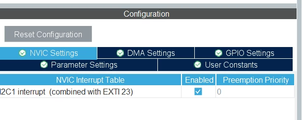

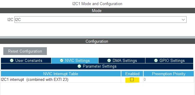

I2C HAL_I2C_SlaveRxCpltCallback is not called on slave after master transmit
I am trying to establish I2C communication between STM32C011 (Master) and STM32C031 Nucleo Board (Slave).
I transmit a message from the master, however, the slave side sees that the master wants to write to the slave (using HAL_I2C_AddrCallback) however, the HAL_I2C_SlaveRxCpltCallback is never called.
In another post, I see that the buffer length may be an issue, so I tried to transmit just one character but to no avail.
ChatGPT suggested I shouldn't re-arm the HAL_I2C_Slave_Receive_IT function as it can cause it to get stuck. I tried it with and without but same result.
I see "Master wants to write to slave" only once upon power up/reset of the slave MCU.

Karl Yamashita
Principal
Jun 6, 2025 10:39 PM UTC
Did you enable the NVIC?

Yes, on the slave side (STM32C0 Nucleo Board) where I use interrupts, I have enabled the NVIC.
