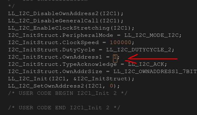

I2C. address is not transmitted after START condition
Hi, I'm trying to write i2c ISR by myself with LL. But after START condition address don't transfer(I see it in my oscilloscope), although I write to I2C1->DR address of slave and read reference manual with attention for proper handling.
I generate initialization code with CubeMX, so there should not be errors in this part.
Here's my code of freertos task:

As I said, on SCL line I see falling edge and no pulses. On SDA nothing occurs - high level remains. I tried debugging - interrupt really occurs and condition on 5th line of code passes and 6th line executes. After that interrupt don't want to fire anymore and address just doesn't get transmitted. Maybe somebody encountered this kind of error? I'm trying to follow reference manual precisely, but can't get result. Thank you in advance!

FSky.1
FSky.1Author
Feb 6, 2023 5:36 PM UTC
Guys, you are not gonna believe! I've just set i2c address of my device and now it just works. It seems like stm's i2c controller dont bother it runs as master. It craves address of slave anyway lol. Is this bug in stm32 microcontrollers? It said nowhere about it0693W00000YA5EZQA1.png
