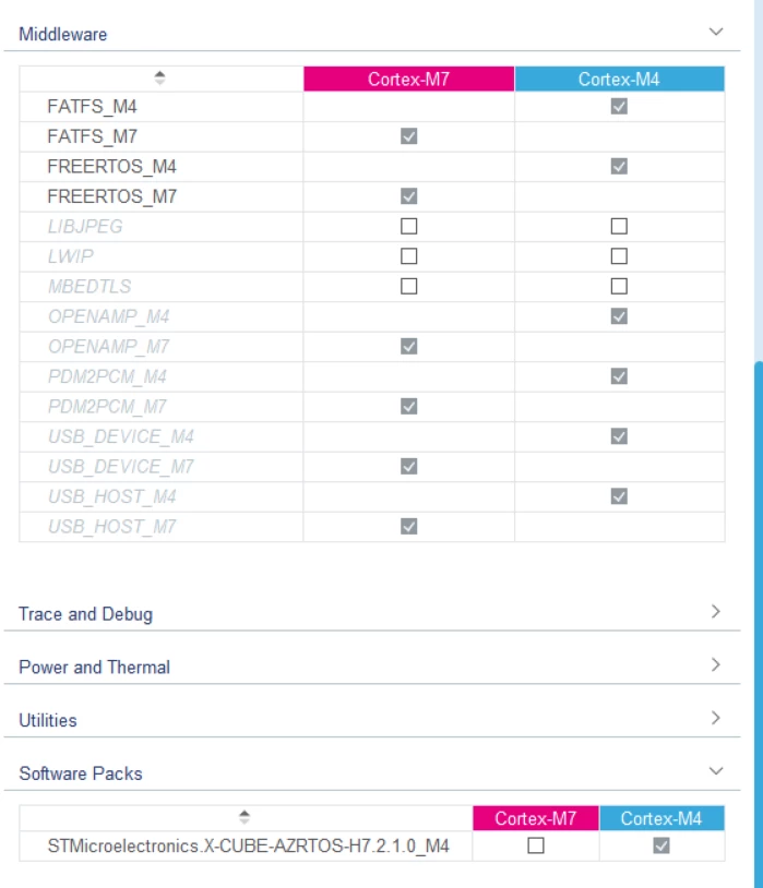

I've created a project for stm32H745 (dual core) and add the threadX support from software package, but I see it only for the CM4, not the CM7 (and I have also free-rtos selected which is enforced for both). Is it correct?

also, does the cubemx put together both free-rtos and threadx or if I choose threadx it superseed the free-rtos?
0693W00000WL5zYQAT.pngmany thanks

My apologies, the checks are indeed active but if you click over CM4 the rtos setting is desabled

Hi @EDallaVia​ ,
Indeed STM32CubeMX does not allow using FreeRTOS & ThreadX in the same project, you'll need to select one.
regards
