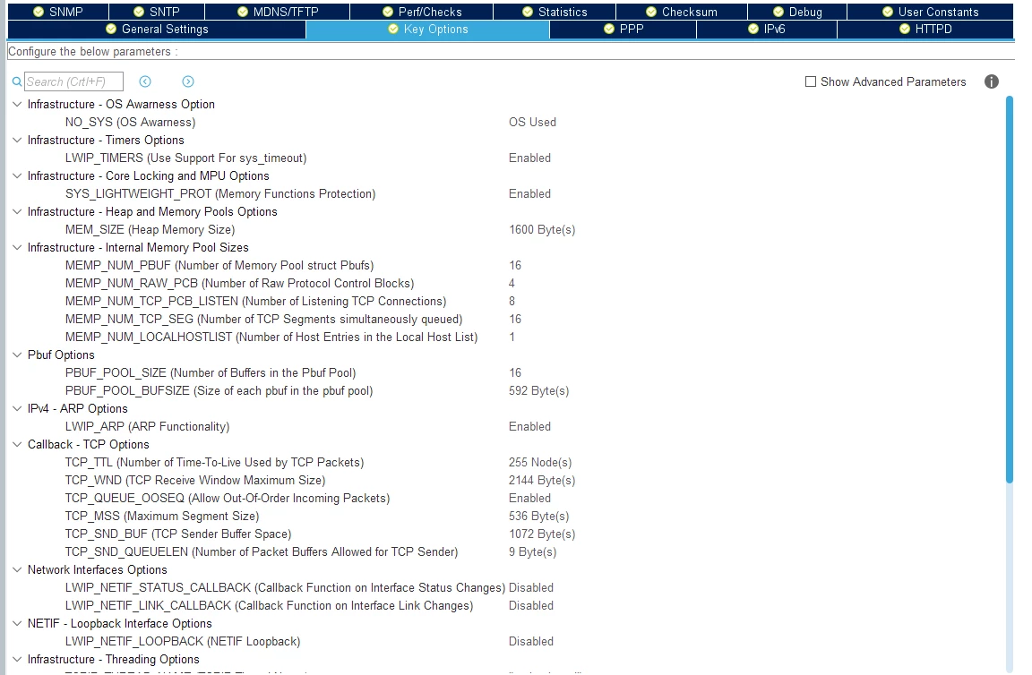

I maked simple program with LWiP, and call netconn_bind(conn, IP4_ADDR_ANY, port) halted MCU board nucleo-f767zi.
I maked simple program with LWiP. After I got dinamyc address, I tried socket connection and call netconn_bind halted MCU.
My code:
 for(;;)
  if(OK_D == 0)
    IP_A = gnetif.ip_addr.addr;
    if(IP_A == 0)
      HAL_GPIO_WritePin(GPIOB, GPIO_PIN_7, GPIO_PIN_RESET); // led 2
      HAL_GPIO_WritePin(GPIOB, GPIO_PIN_14, GPIO_PIN_SET); // led 3
    } else
      dhcp_stop(&gnetif);
      OK_D = 1;
  } else
      HAL_GPIO_WritePin(GPIOB, GPIO_PIN_14, GPIO_PIN_RESET); //led 3
      osDelay(1);
      if(OK_E == 0)
        conn = netconn_new(NETCONN_TCP);
        if(conn != NULL)
          HAL_GPIO_WritePin(GPIOB, GPIO_PIN_7, GPIO_PIN_SET); //led 2
          osDelay(1);
          err1 = netconn_bind(conn, IP4_ADDR_ANY, 100);
          osDelay(1);
          err2 = netconn_connect(conn, &IP_Server, 21000);
          if (err1 == ERR_OK)
            OK_E = 1;
Please, help me resolve this problem.
LWiP settings in CubeMX:

This problem solved as follows, I ran functions netconn_new, netconn_bind, netconn_connect in separate thread. This thread maked with function sys_thread_new.
And, it`s ok in my case.
