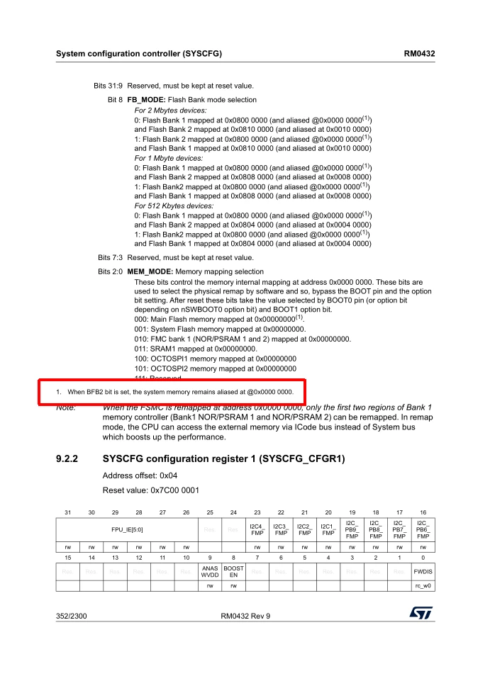

> "Break at address "0x1fff06f6"
That's in the system memory = built-in bootloader area.
If you set BFB2, system memory remains mapped at 0x0000'0000, so the bootloader's interrupt table is at 0x0000'0000, where VTOR points to by default.
Make sure to set VTOR to 0x0800'0000 before enabling any interrupt.
