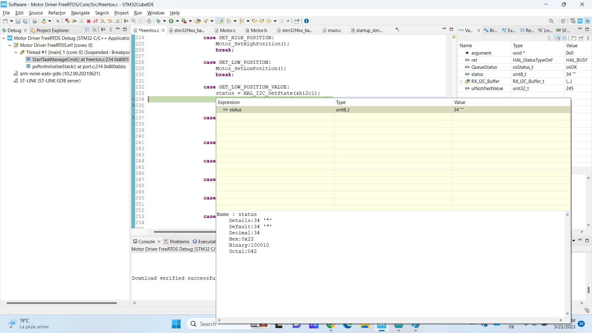

I'm getting HAL_I2C_STATE_BUSY_RX
I have developed a code in FreeRTOS mode that contains two main tasks. The first one check if I have received an RX buffer on the I2C bus, and the second one manage the data that has been received.

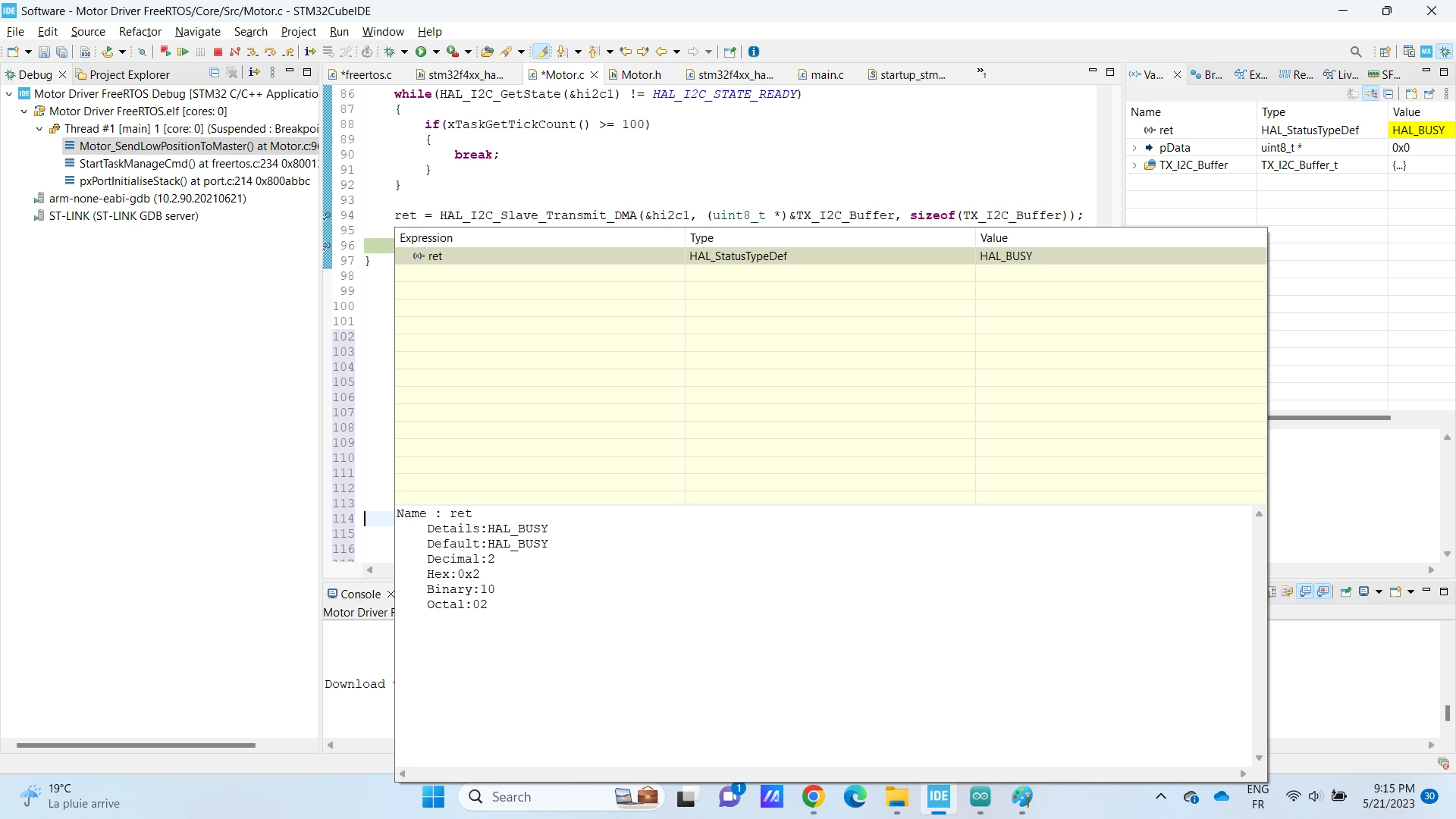

However, after receiving the first buffer, I am getting HAL_I2C_STATE_BUSY_RX, and I cannot transmit a response to the master device but I'm able to receive another RX buffer . Can anyone please help me?
I'm using I2C in DMA normal mode.
_legacyfs_online_stmicro_images_0693W00000bkVdiQAE.png32-> HAL_I2C_STATE_READY
_legacyfs_online_stmicro_images_0693W00000bkVdJQAU.png34-> HAL_I2C_STATE_BUSY_RX

Yes, that's correct. When my code recall HAL_I2C_Receive_DMA() once this function returns HAL_OK indicating that the reception is successful,
I proceed to send a notification to the second task to inform it about the detection of an RX buffer. Subsequently, I transmit this buffer to the second task by a queue.
< if(HAL_I2C_GetState(&hi2c1) == HAL_I2C_STATE_READY)
 ret = HAL_I2C_Slave_Receive_DMA(&hi2c1, (uint8_t*)&RX_I2C_Buffer, sizeof(RX_I2C_Buffer));
 if(ret == HAL_OK)
 QueueStatus = osMessageQueuePut(I2CBufferQueueHandle, &RX_I2C_Buffer, sizeof(RX_I2C_Buffer), 500);
 xTaskNotify( xTaskMannageCmdHandle, RX_I2C_SUCCESSFULLY_DETECTED, eSetBits);

You can't have RX_DMA active and try to transmit. I2C can only do one at a time. Since you are the slave, there should not be any more incoming data until you have sent your response. So don't restart the receive until after you have sent your response.
And a curiosity: why do you use BOTH a queue and task notify? just posting to the queue should be sufficient.

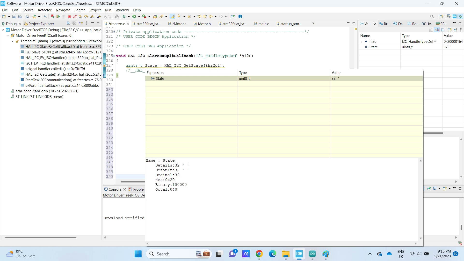

< while (1)
 HAL_GPIO_WritePin(GPIOA, GPIO_PIN_5, GPIO_PIN_RESET);
 ret1 = HAL_I2C_GetState(&hi2c1);
 if(HAL_I2C_GetState(&hi2c1) == HAL_I2C_STATE_READY){
 ret = HAL_I2C_Slave_Receive_DMA(&hi2c1, rxbuffer, sizeof(rxbuffer));
 if(ret == HAL_OK){
 HAL_GPIO_WritePin(GPIOA, GPIO_PIN_5, GPIO_PIN_SET);
 /* USER CODE END 3 */
void HAL_I2C_SlaveRxCpltCallback(I2C_HandleTypeDef *hi2c)
BufferReceived++;
In the first iteration of my while loop, the code detects an I2C RX bus, but it's not true because I'm not sending anything from the master. After that, if I set a breakpoint on the line ret1 = HAL_I2C_GetState(&hi2c1); , I get ret1 = HAL_I2C_BUSY_RX, but despite that, I am able to receive from other I2C buses, but I'm not able to transmit. This problem occur when I use DMA or IT mode
