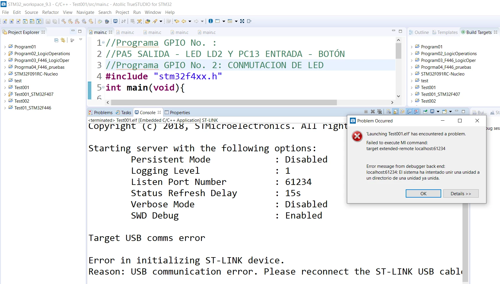

I am using TrueStudio and trying the Nucleo 64 STM32F446RE.
when I try to debug, the console always shows
Starting server with the following options:
    Persistent Mode      : Disabled
    Logging Level       : 1
    Listen Port Number     : 61234
    Status Refresh Delay    : 15s
    Verbose Mode        : Disabled
    SWD Debug         : Enabled
Target USB comms error
Error in initializing ST-LINK device.
Reason: USB communication error. Please reconnect the ST-LINK USB cable and try again.

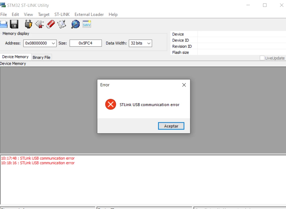

I checked to use the STM32-LINK Utility. There is a communication error.
Tried to execute dpsint_amd64 using the path C:\Keil_v50\ARM\STLink\USBDriver
changed the USB cable

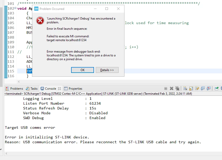

I have the same problem with STM32CubeIDE 1.8.0
Ahmad M.Nejad
February 22, 2022
I solved the problem by reinstalling ST-LINK server software!
