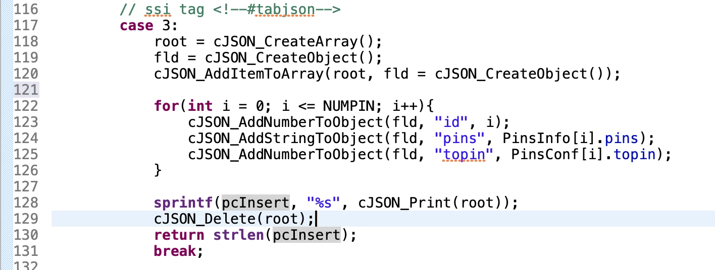

I have a Lwip problem with SSI module.
The problem with the insert of the SSI tag, it is can insert only 920 characters but I need in 5 times more!
If I change the "Lwip_httpd_max_tag_insert_len" It does not give an effect!
Could someone tell me what is wrong?
