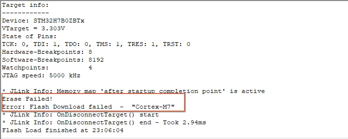

I generate a flm file, but failed when use this flm to download external flash.
I made  a project on keil with generate flm file to download to external flash with my board. My board has a stm32h7b0zbt6 chip with ospi interface with a spi nor flash W25Q128. the interface releate is:
PF6 ------> OCTOSPIM_P1_IO3
PF7 ------> OCTOSPIM_P1_IO2
PF9 ------> OCTOSPIM_P1_IO1
PB2 ------> OCTOSPIM_P1_CLK
PD11 ------> OCTOSPIM_P1_IO0
PC11 ------> OCTOSPIM_P1_NCS
and I append the project , is there anyone can help me to check the project ?
When I try to use this flm file to download code on keil, I get errors like below:

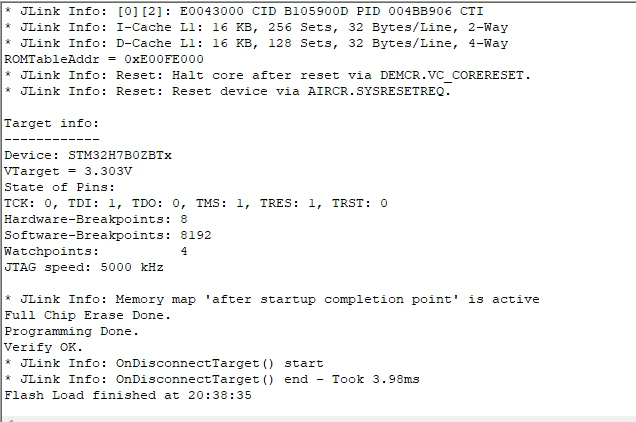

https://github.com/cturvey/stm32extldr/blob/main/h7_w25q128/README.md#support
https://github.com/cturvey/stm32extldr/blob/main/h7_w25q128/W25Q128_STM32H7AX-CUSTOM30.FLM

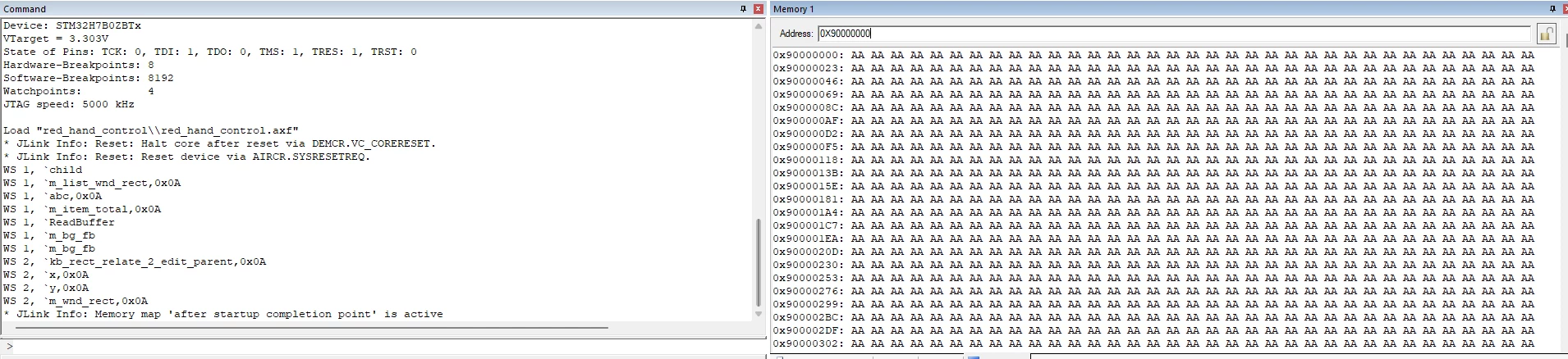

thanks for your help , after I check this flm file, I found all data get 0XAA , I do not know why cause this ?
