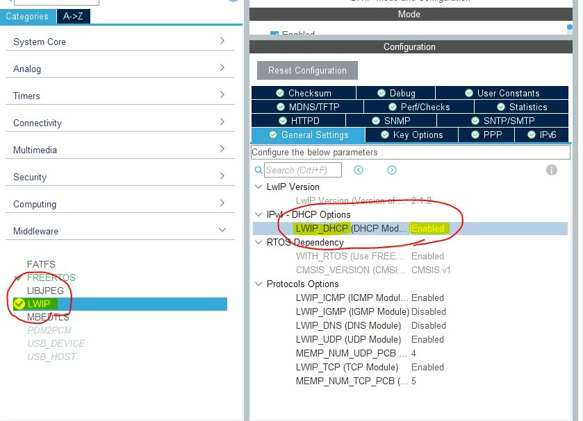

I'd like to make TCP/IP communication with DHCP on freeRTOS.
Hi everyone.
I would like to know how to use DHCP and check if DHCP is working what I expected.
Please, confirm my process for using TCP/IP communication with DHCP on freeRTOS.
First, I make CubeMX configuration.
0693W00000ANo3VQAT.jpgLike this, I make DHCP_Module enable.

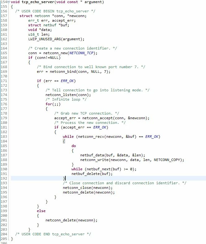

And then, I put TCP/IP echo server C code on RTOS.
0693W00000ANo4OQAT.jpgBelow I attach the TCP/IP echo server thread C code.

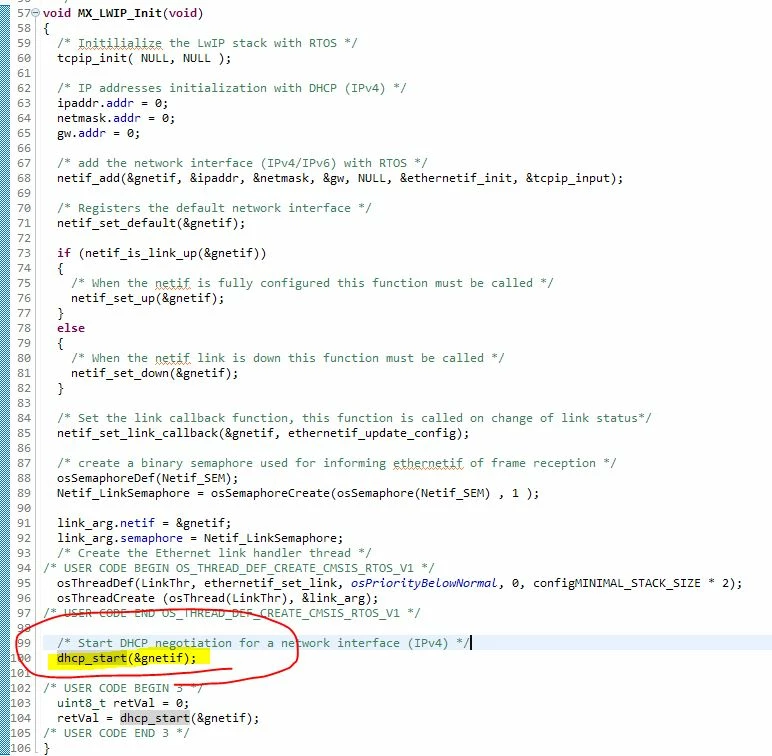

Also, I double-check that there is 'DHCP start' code.
0693W00000ANo45QAD.jpg In 'MX_LWIP_Init()' function, I could find the dhcp_start function.
So,,,.,.,., I think I did all the progress that I can do....
However, I can not connect any DHCP server program, even Window's DHCP mode.
Of course, I use IP Router device.
Is there anybody who using TCP/IP communication with DHCP on freeRTOS??
Or Is there any example??
Or My process is right??
Please help me to get out from this puzzle :(

Hello @EHa.1​ ,
Unfortunately, we do not have an example DHCP developed in our CubeFW.  But LwIP provides a DHCP test under Middlewares\Third_Party\LwIP\testunit\dhcp that might help you.
