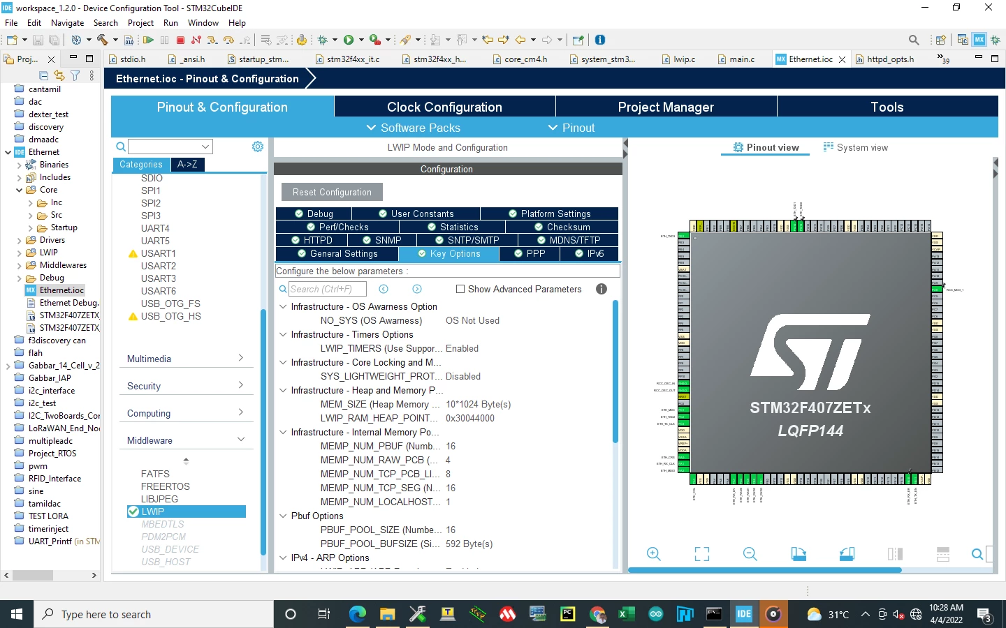

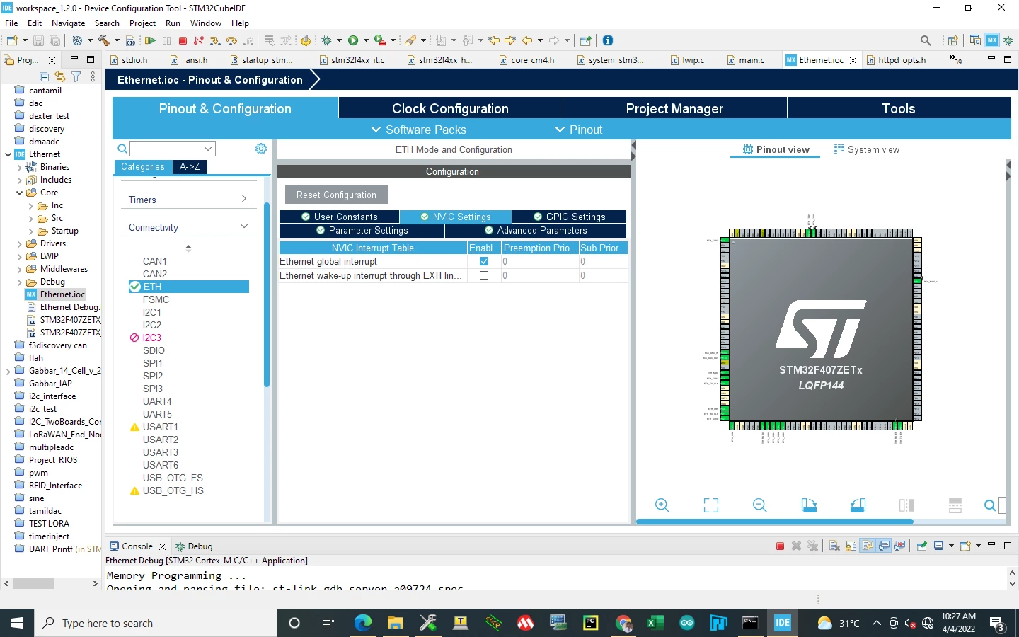

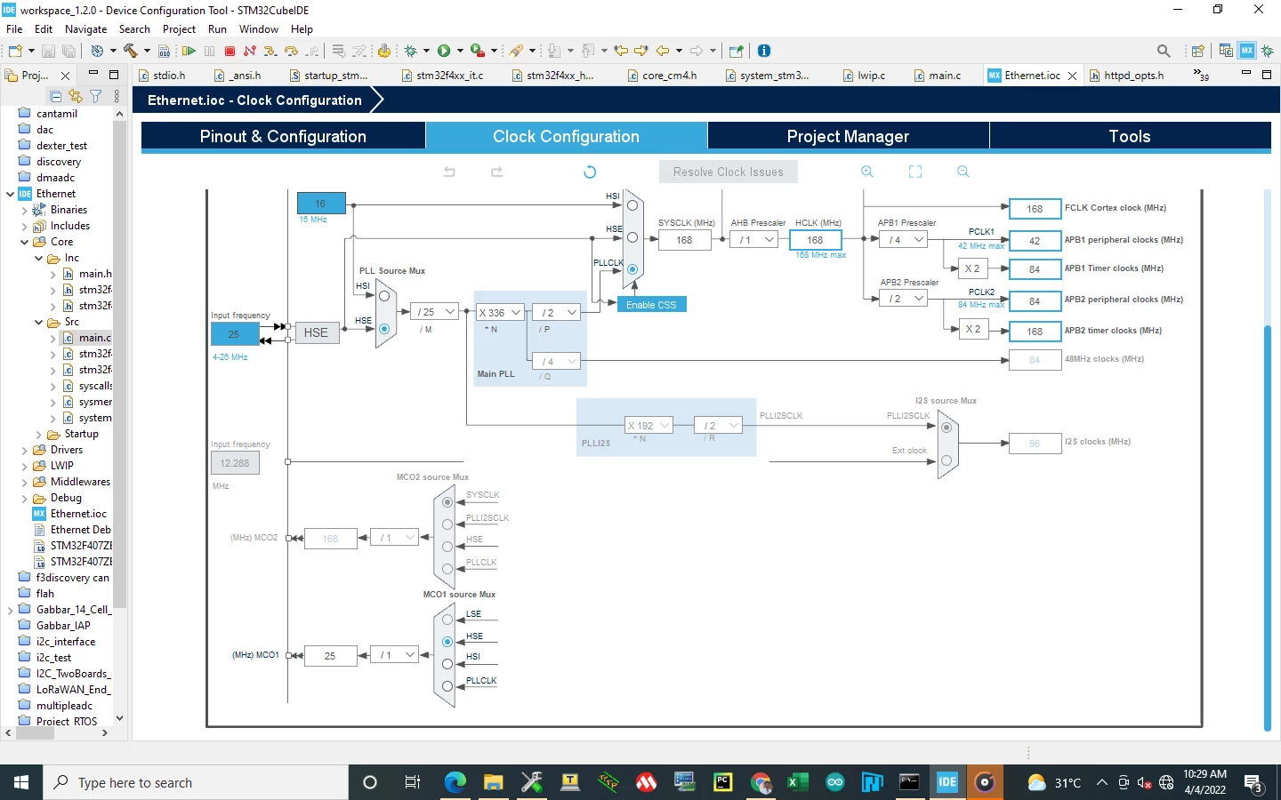

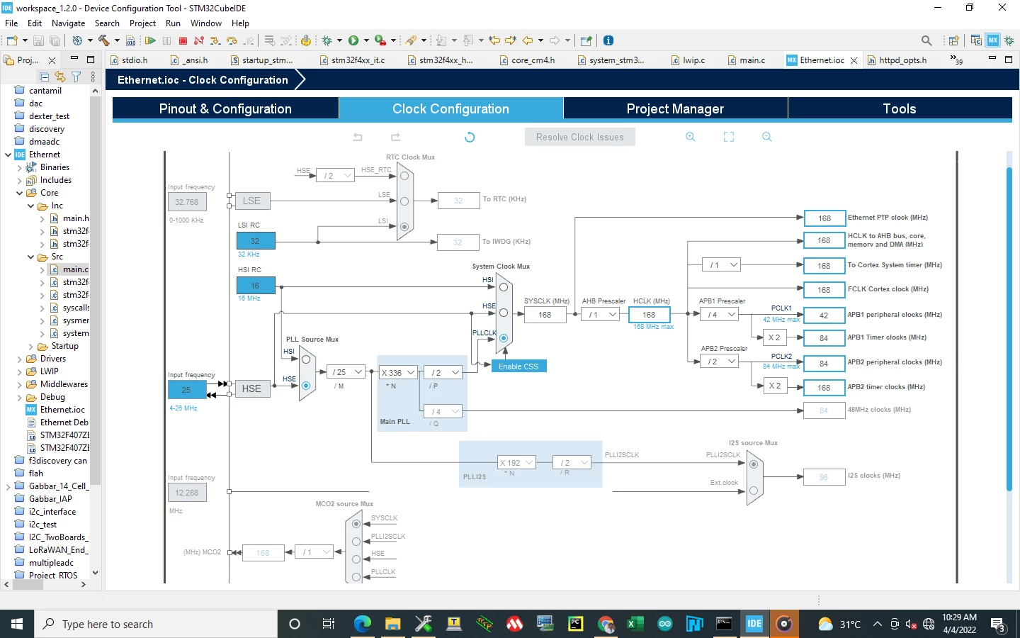

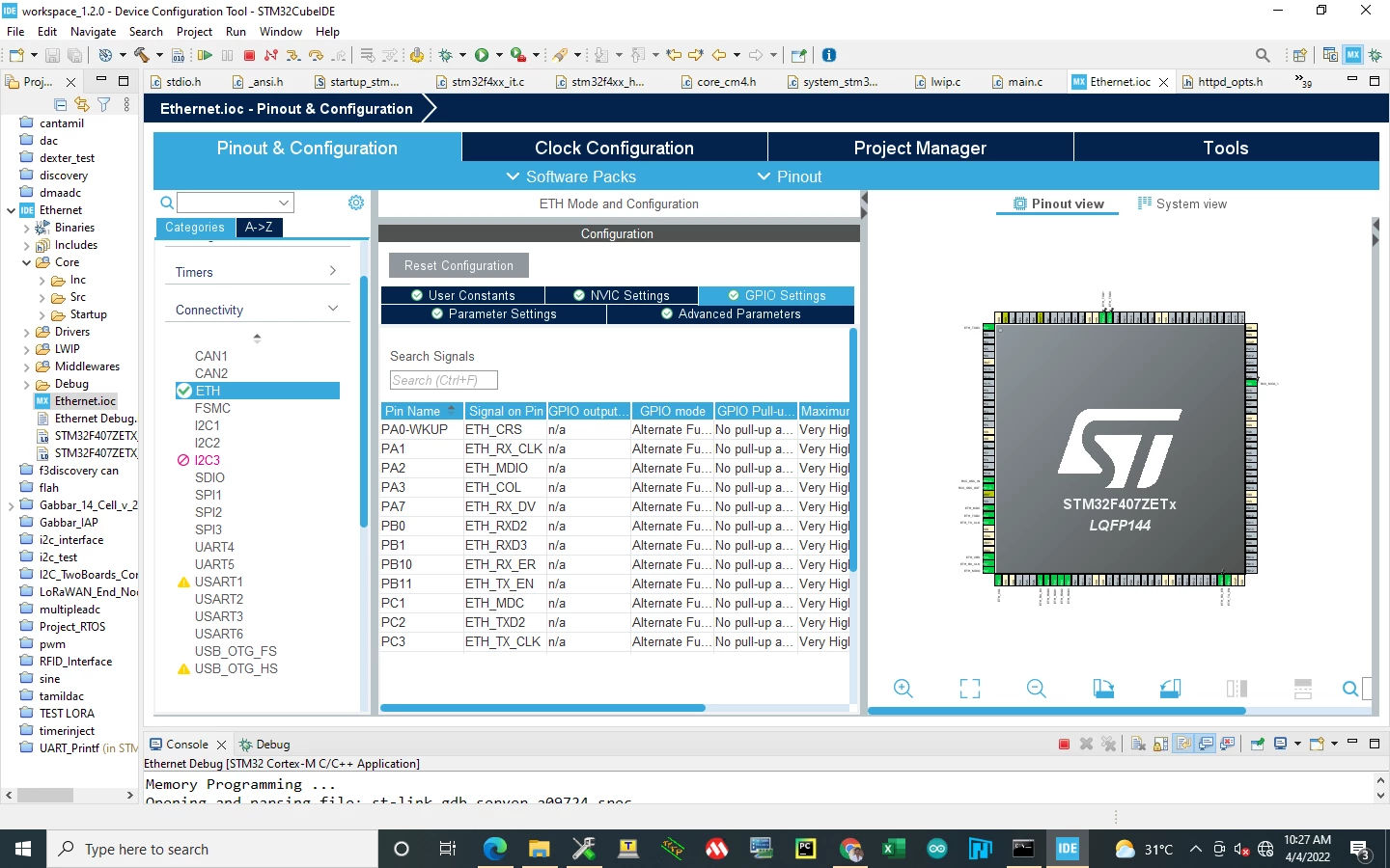

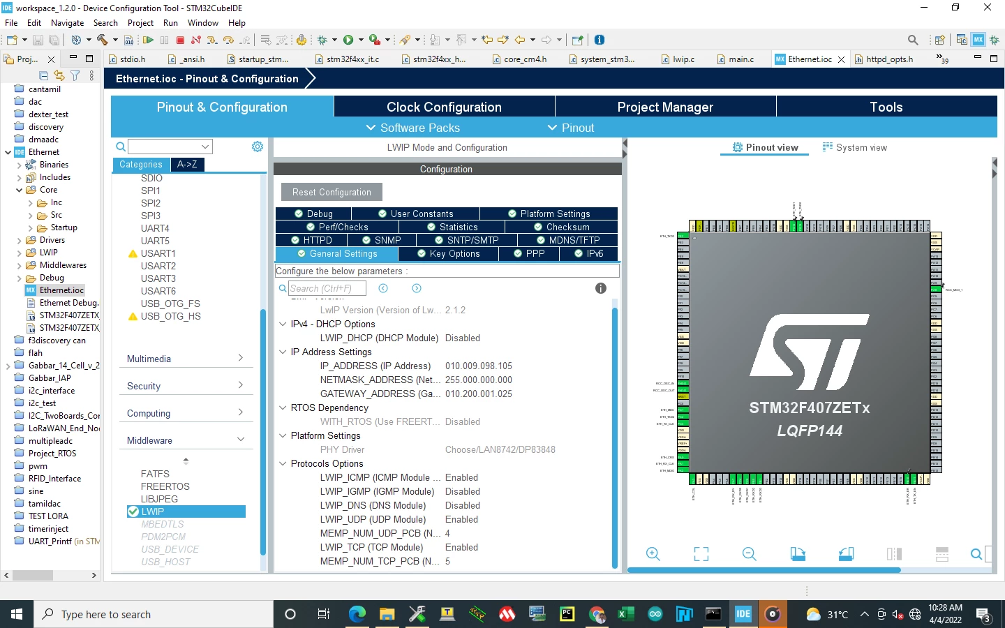

I configured ethernet and LWIP on STM32F407 as follows. But I'm not able to ping it and ethernet interrupt is not coming. Kindly help me resolve this issue.
