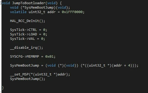

I cant jump while loop in main
Posted on August 18, 2017 at 15:52
After I jump to the system memory location to make bootloader I cant jump back even if I press reset pin.How can I properly jump new code to run?(I am working on stm32f4 discovery)

Reset should be agnostic, perhaps you should review more carefully the design around NRST and BOOT0 as it implemented on the board. Don't drive NRST high.
A reset would fail if you mass erased the part, or tried to turn off protection.
Use a 'halt debugger' to see where it is in the problematic condition. Have code in the Reset_Handler so you can check it arrived there, and perhaps died elsewhere.

Who/where would interrupts be re-enabled? not a reset condition
SYSCFG clock must be enabled to change mapping
Reset should re-enter your code based on BOOT0 pin being pulled-low. How are you sure it is not entering Reset_Handler?
Does the system loader use a watch-dog?
This is not my recommended method to enter the system loader.

No watch-dog.I cant use boot0 pin so I must enter system loader in code.I thought that everything would come back when I press the reset.What do I have to do to work like the  previous?
