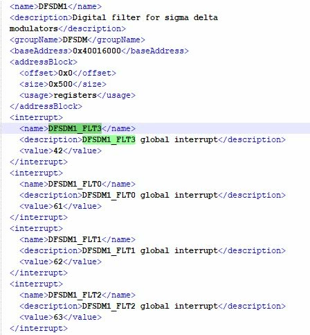

I cannot see the status of the registers DFSDM1_Filter2 and DFSDM1_Filter3 in register view STM32l496ZG.
When you configure DFSDM faced with the problem that I can't see the status registers a custom filter, due to incorrect file STM32L4x6.svd because the register addresses according to this file do not match those described in the Datasheet and in the HAL library.
On the site of ST not submitted file STM32L4x6.svd which would have been valid addresses.
Does it exist and where can I get it?

Mar 4, 2019 2:44 PM UTC
Hello @Dumpler​ ,
Do you mean svd file missing DFSDM1_FLT2 and DFSDM1_FLT3 ?
I checked the version STM32L4_svd_V1.2 and found these  global interrupt.
Kind Regards,
Imen
Dumpler
DumplerAuthorBest answer
Mar 4, 2019 2:53 PM UTC
This interrupt, in order to see the register values I had to modify the svd file according to the values from HAL, only then everything worked as it should.
