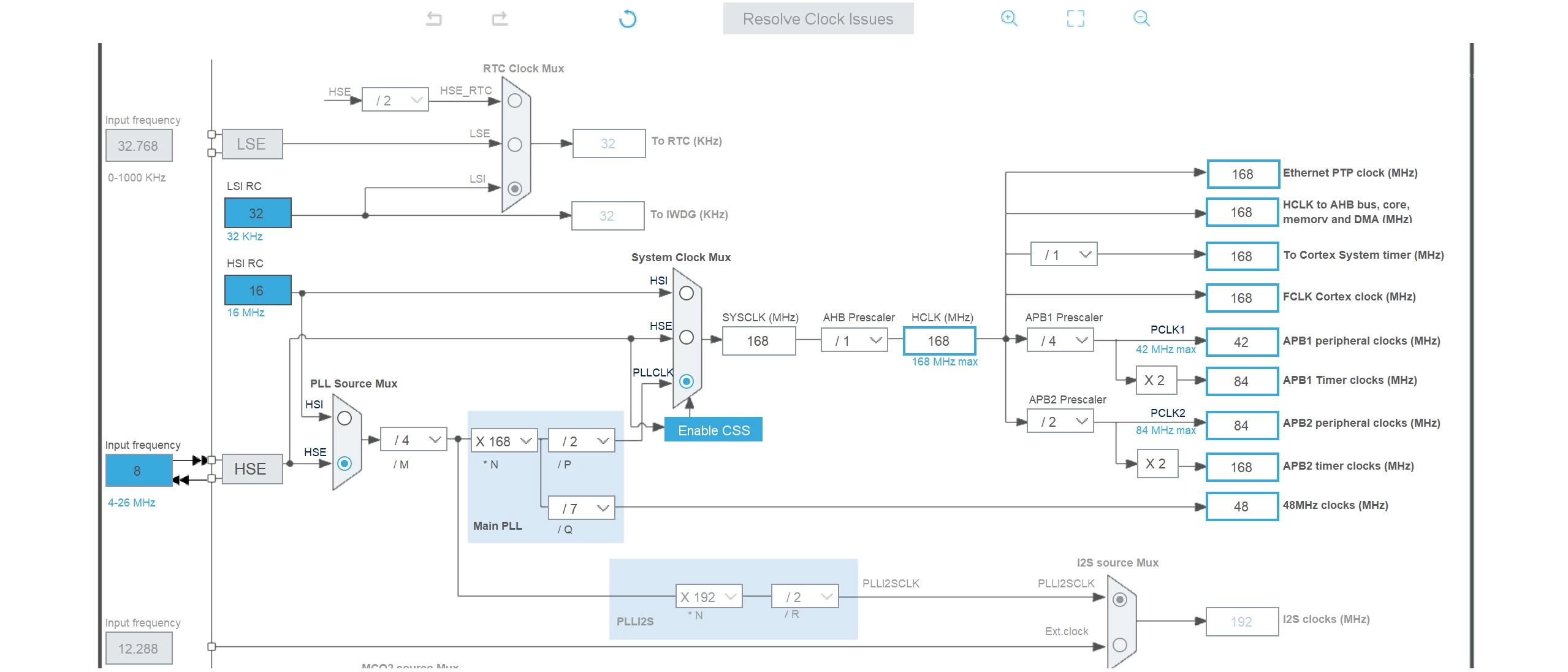

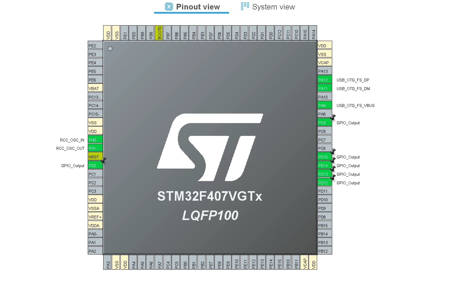

I am working with STM32F407 to write a text file to Pendrive (USB Host). But i am getting FD_DISC_ERR. When I debugged more i understood that this is due to HOST_DEV_WAIT_FOR_ATTACHMENT issue. Can anyone help why this is happening?
3 replies
Ajithkumar
Mar 27, 2023 4:27 AM UTC
These are the pinout and clock config diagram

Try ClockDiv with 2 or 4.
I advise you to get inspired from the available examples available with STM32CubeF4 MCU package, and you will find more details on this article: Introduction to USB with STM32.
Make sure to use latest versions of STM32CubeMX and STM32CubeF4 MCU package.

Not worked. I tried with multiple clock vales.
I tried with example project in CudeIDE as well as i created new project from scratch but not worked me both.
Is any Size limitation for Flash Drive size ?
I mean I tried with 16GB and 32GB Flash Drive
