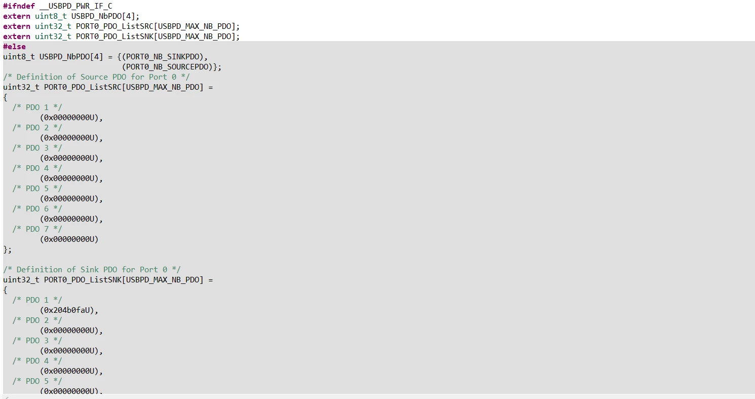

I am using the USB-PD protocol with the stm32G071RBT6 processor with the tcpp01 card. I can only get 5v at the output(Vbus). I can't get 20v(Vbus). what should I do. APPLICATION NOTE(AN5418) , TCPP01-M12 DOCUMENT AND LINK OF USB-PD CODE BELOW.

Dear @Mtopa.1​
You could refer to AN5418 and mainly the §5.1.4.
Idea is to change the Sink PD0 to accept 20V. For instance, if you want to have a Sink PDO 20V/3A, you should put the value '0x0006412C'.
In our GO demonstration, we provided user macro to help writing PDO:
STM32G081B-EVAL/Demonstrations/DemoUCPD/Inc/usbpd_pdo_defs.h

Thank you Nicolas,
I don't know how to change output value in sink application. Output is fixed with 5v as default how can I change it.

Thank you Yohann,
When I set sink pdo from cubemx, the section with sink pdo in cubeide comes as a comment line. How can I remove it?

What do you mean by comment?
'U' at the end of the PDO is a C keyword to indicate the value is an unsigned int.
Note: you agree that 0x204B0FA is not a valid Sink PDO!
