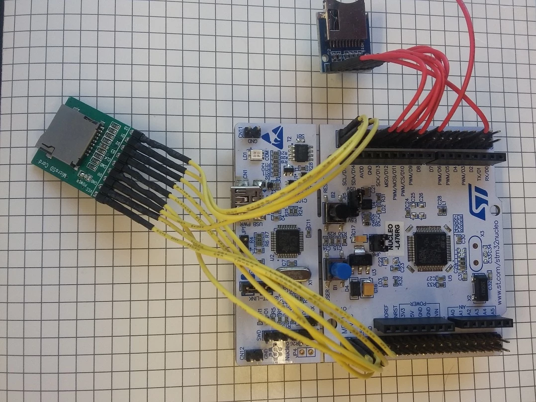

Tesla DeLorean
Guru
Jul 22, 2021 9:36 PM UTC
0690X000006CGatQAG.jpgYes, the AdaFruit SPI implementation (see BSP) for NUCLEO is also a good starting point but the NUCLEO-L476RG also supports SDMMC and will be significantly faster.
