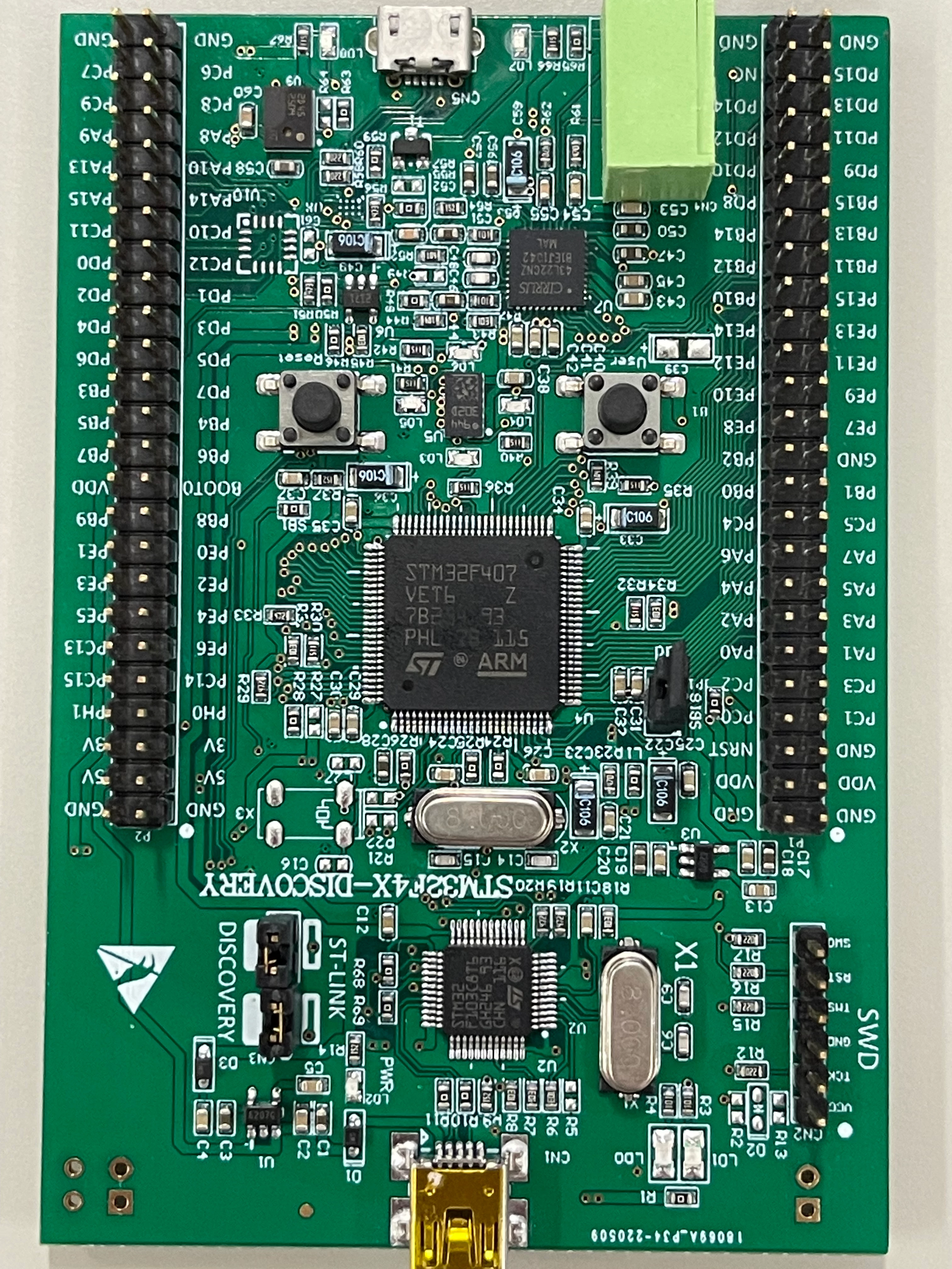

I am using a STM407VET6 development board, and when I connect it via USB, it is recognized as "STM32 ST-Link" as a USB device, but not as a VCP. How can I solve this problem?
What board? Post photo.
JW​
tacchi
tacchiAuthor
Aug 3, 2022 6:01 AM UTC
0693W00000QMp2GQAT.jpgI'm using​ this board.

This board has a ST-LINK/V2-A which does not include VCP. See
STM32F4DISCOVERY Data brief and
TN1235 Overview of the ST-LINK versions.
hth

Can add VCP by soldering 2 wires, see UM1472 Discovery kit with STM32F407VG MCU

Already made wire connections but It was not recognized as a Virtual COM Port in Device Manager.
Could it be that this device does not allow serial communication using TeraTerm or similar?

Have you upgrade the ST-LINK firmware uisng STM32CubeProgrammer or such? The tool should state the link type: Debug+MSC+VCP

This
  • is not a genuine ST board, it's a clone
  • as the STLink is STM32F103C8T6, it cannot support the STLinkV2-A firmware which has the VCP (that would require STM32F103CBT6), only the older STLinkV2 firmware without VCP

Understood.
Thank you very much.
