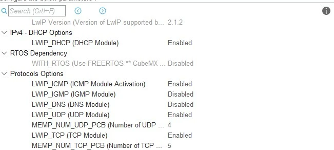

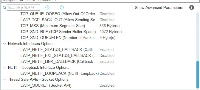

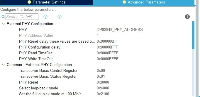

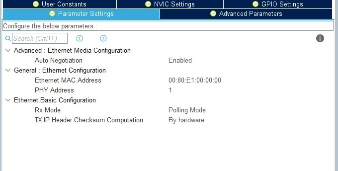

MKoca.1
MKoca.1Author
Senior
Aug 26, 2021 1:41 PM UTC
0693W00000DqTd3QAF.jpg0693W00000DqTcyQAF.jpg0693W00000DqTctQAF.jpg0693W00000DqTcoQAF.jpg
