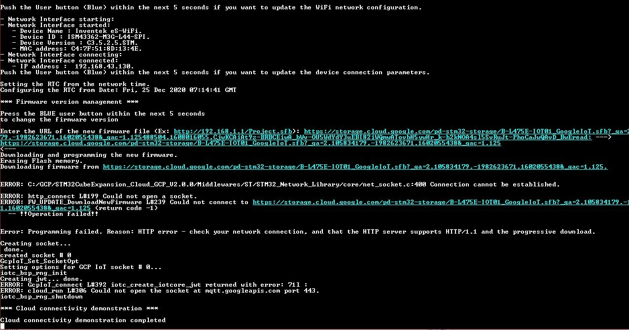

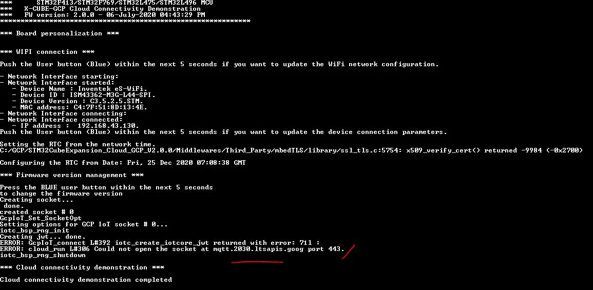

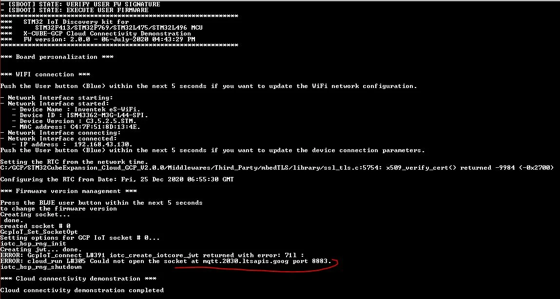

I am trying to make X-CUBE-GCP working but till now there is no any sign of success. The major issues I am facing is with mqtt connection not being established.
0693W000006GtgDQAS.jpgAs shown above, the error is coming after jwt is created successfully. I checked the default mqtt hostname is not working with my sample python code.
I changed the hostname to mqtt.googleapis.com and port number but still facing same issue.0693W000006GtgIQAS.jpgAs suggested in documentation, I thought the problem is with firmware and tried to updated the firmware with gcp storage account. But there is no success updating the firmware-0693W000006GtgNQAS.jpg
Please suggest whether there are any missing steps. I need to make this quickstart demo working before I can start the actual development. Thanks

Duy Tran
January 14, 2021
If you readback the log, you will see that the JWT was not created properly - error 711. There are several reasons for this, but mostly are from user side. For me I was entering the wrong private key.

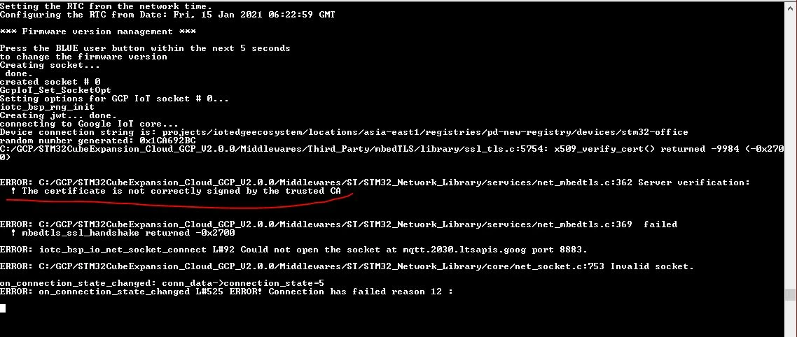

0693W000007BMomQAG.jpgDuy, Thanks for the reply. I am really stuck working with this SDK. I properly checked public private key pair and resolved all issues mentioned in this post. I was able to make it working and sensor values were getting published on the portal properly.
However, I needed to erase the board and tried to again follow the same process. Now I am facing root CA certificate authentication error. I am sure that I am using the same certificate as mentioned in the SDK path "Middlewares\Third_Party\GCP\samples\STM32Cube\globalsign_usertrust.pem" which was working last time. But now I am getting following error as shown in image.
I looked into full root CA list (https://pki.goog/roots.pem) and tried to pass full CA list but it is not understandable which key to actually use.
I have already invested more than 2 days trying to fix it. Please help!
