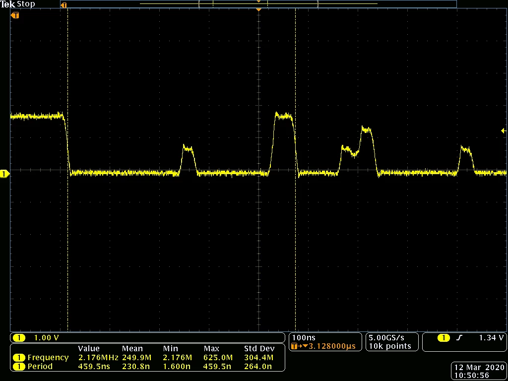

This is a screen capture of a scope trace of TXD1. This signal looks strange. We disconnected TXD1 from the phy so we could see only what was coming out of the MCU. Any ideas why this is happening?
Piranha
Principal III
March 13, 2020
Check the solder quality. Check the GPIO configuration, probably try different speeds for pins.
And this is what I wrote before the oscilloscope screenshot...
It still can be a software issue. Being able to receive few frames on one board doesn't mean that the code is correct. Do you use any of ST's code? Who wrote the ETH driver and related network code? Have you checked the code for issues described in alister's and my topics? =)

We cleaned up the signal, and we got loopback to work on a 1.8V nucleo.
The key issue was here:
   GPIO_InitStruct.Pin = ETH_TX_EN_Pin|ETH_TXD1_Pin|ETH_TXD0_Pin;
   GPIO_InitStruct.Speed = GPIO_SPEED_FREQ_VERY_HIGH; <------------------- This line was to low
   GPIO_InitStruct.Alternate = GPIO_AF11_ETH;
   HAL_GPIO_Init(GPIOG, &GPIO_InitStruct);
Once we set the gpio speed to very high, loopback started working at 1.8V on the nucleo
