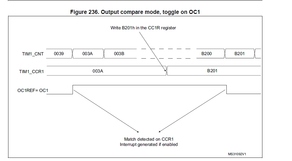

I am not able to understand the difference between following two: __HAL_TIM_GetCompare(&htimX, TIM_CHANNEL_X) __HAL_TIM_GetCounter(&htimX) I checked the datasheet for STM32F031K6T6 but not able to understand the difference.

__HAL_TIM_GetCounter(&htimX) allow to read CNT register where is the value that correspond with current "time". As time We mean nummber of clock cycles. When your CNT register equals ARR register, then CNT register reset and count again.
__HAL_TIM_GetCompare(&htimX, TIM_CHANNEL_X) allows read CCR register. The register used to for example in Output compare mode or input capture mode.
In Output compare mode (toggle mode):
_legacyfs_online_stmicro_images_0693W00000bjNPvQAM.pngYou can manipulate signal when registers have been equal. When CNT == CCR then the signal toggles.
Remeber this is just example. CCR register support many various cases and features

I am trying to use one of the timers as a counter. So that it can read external clock pulses. What I understand from your explanation is that I have to use the following
to check if the pulse at the input pin is high.
Senior III
May 4, 2023 6:07 PM UTC
If you want use timer as counter you don't need compare registers ​

Read the Reference Manual regarding timer capture compares, then read a Timer Capture example included with the HAL Library.
A capture event (e.g, input pulse high) saves the contents of the Timer Counter, and this event can be sensed with a timer interrupt, so a separate and less accurate __HAL_TIM_GetCounter is not required.
