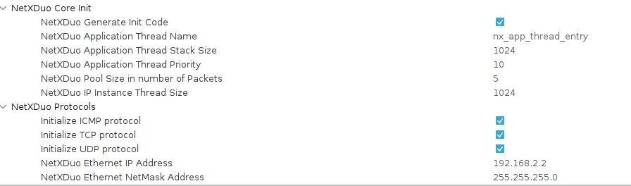

Here is my feedback:
1) I Do Not see a "Common Init" feature, but I do see in the NetXDuo Core Init this:
0693W00000aIcG2QAK.pngAs you can see here, I do not see a check box to disable DHCP.
Perhaps I need an updated version of CubeIDE/MX or perhaps there is significant detail you have not revealed.
2) Have you tried this using my code or is this an untested suggestion?
Pavel A.
March 9, 2023
You need to update CubeMX/IDE.
GreenGuy
GreenGuyAuthor
Senior III
March 10, 2023
Done.
CubeIDE: Version: 2.0.100.202301271415
CubeMX: Version: 6.8.0-RC4
Re-Built - No errors
Did not fix the problem.
