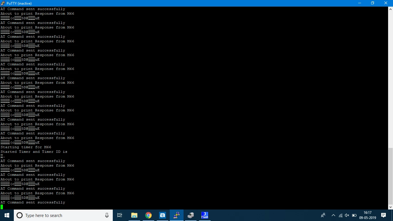

0690X000008BSx6QAG.pngI am using STM32F103C8 board and CubeMX to create the code. I have connected the M66 to STM32 to UART2 port. I try to send some commands to Quectel M66 via STM32's UART port. It receives the command but throws some junk characters. I have set the baud rate as 9600 for all UART ports. This is my code
void M66_Check()
 char *buffer = "ATI\r\n";
 char *rec_buffer = NULL;
 rec_buffer = (char*)malloc(200 * sizeof(char));
 if(HAL_UART_Transmit(&huart2,buffer,strlen(buffer),200) == HAL_OK)
 printf("AT Command sent successfully\r\n");
 HAL_Delay(1000);
 else
 printf("Not Sent\r\n");
 HAL_UART_Receive(&huart2,rec_buffer,50,200);
 printf("About to print Response from M66 \r\n");
 HAL_Delay(2000);
 printf(rec_buffer);

You delay 1s, while not ready to receive any data, the chip doesn't buffer.
Is 200ms long enough to receive 50 chars?
The receive blocks.
You delay another 2s.
Don't handle NUL termination of the string properly.
VR_it
VR_itAuthor
May 9, 2019 1:20 PM UTC
does Delay matters for receiving data from particular UART port? I did to see visually my code flow.. otherwise it would be fast and i could not see the flow..that's why i put it.
Tesla DeLorean
Guru
May 9, 2019 1:34 PM UTC
Well doing blocking IO to the UART and waiting 1s afterward, in a sequential fashion seems to be problematic in that the RX/TX on the port can occur simultaneously, and the modem is going to respond in a fraction of a second, while your code isn't paying attention, and the STM32 isn't magically buffering the data.
Waiting for 50 characters, is likely another issue, this will likely timeout in 200ms as the modem's response is probably less than a dozen characters. I you have not code to scope the content of the buffer, or deal with the NUL that all the string handling code requires, ie printf()

I have found out the problem... I needed to transmit and receive in these formats....
I missed those (uint8_t *).
To Transmit - HAL_UART_Transmit(&huart2, (uint8_t *)buffer, strlen(buffer), 100);
To Receive - HAL_UART_Receive(&huart2, (uint8_t *)rec_buffer,50,2000);
Now there is no problem and I am getting the response correctly.
