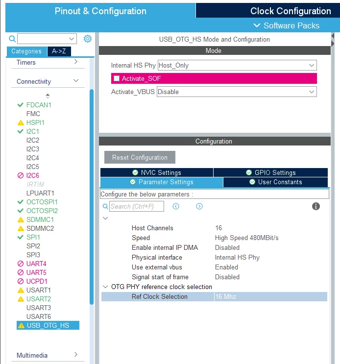

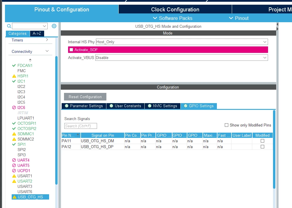

In CubeMX I have the following settings:

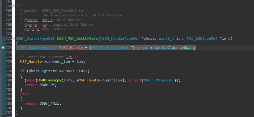

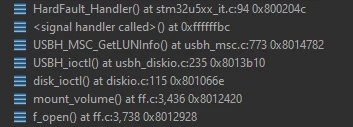

But I am getting a hardfault in the f_open and more specifically, the call stack looks like this:
So the exact point that it seems to be failing is:
So far I have edited the
