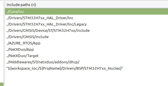

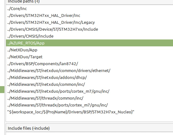

In that project I, removed the dhcp addon within the .ioc (opened CubeMxIDE) and regenerated the project. It is interesting to note that the regenerated project was now missing all of the Middleware include paths.
It first looked like this in the project it was copied from:
0693W00000JQ6tFQAT.pngthen it turned into this after the regeneration:
0693W00000JQ6tZQAT.pngTo fix it I had to go back through and manually add the paths back.
I used the method of right click on the folder of interest in the project tree and select "Add/Remove include path".
I double checked that making a copy of the project would copy the include paths correctly so it was definitely a fault of the regeneration after the Addons DHCP Client feature was unchecked in the Software Packs Component Selector.
