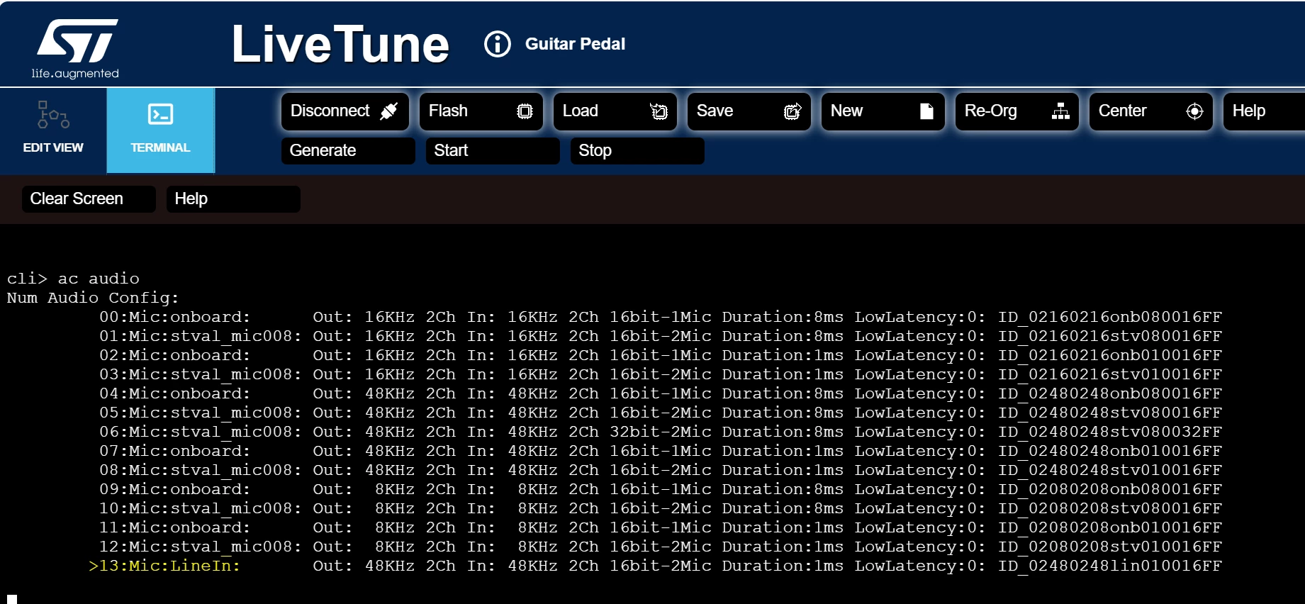

How to use the line level input of a STM32H735G-DK with LiveTune
I am using the STM32H735G-DK development kit to evaluate the LiveTune audio kit capabilities.

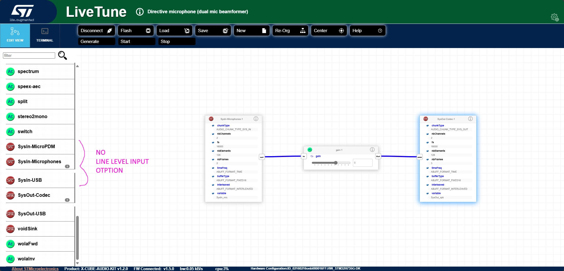

When connecting to the dev board it shows several audio input source but does not show one for the Line Level input on connector CN11.
How do I use the Line Level Input with the LiveTune software?
Only options shown are
  • SysIn-MicroPDM
  • SysIn-Microphones
  • SysIn-USB
1 reply

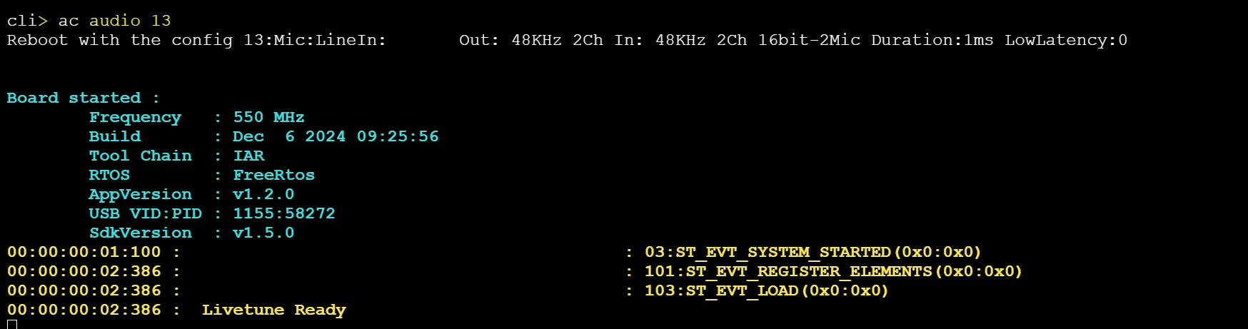

After connecting your STM32H735DK board to the LiveTune platform, please follow the steps below using the terminal and the provided screenshots:
cli>ac audio : List all configuration available. ( screenshot 1)
cli>ac audio 13 : Select the Mic:Line  as configuration and reboot  ( screenshot 2 )
screenshot 1screenshot 1
screenshot 2screenshot 2
-->  Now, the LineIn configuration is complete.
