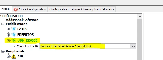

YAY.1
YAY.1Author
Senior
Jul 14, 2020 7:05 PM UTC
0693W000001srSUQAY.pngJust i could not do this , How can i do this with assembly language ?
