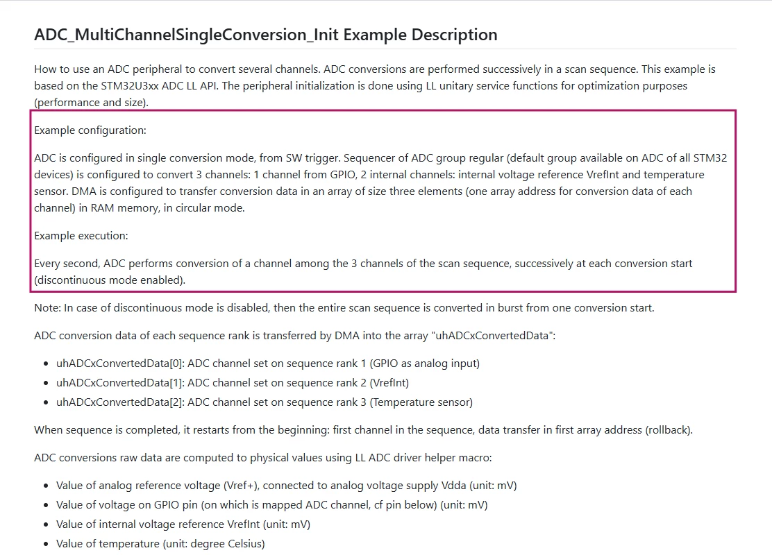

Hi All,
I am using STM32U375RETx on in my project on a custom board. I am using 8 channels on ADC1 and 3 on ADC2. I want to scan all the channels using DMA. I have configured the ADCs in scan conversion mode using dma and have also configured the gpdma channels to connect with the ADCs.
My issue is that I am unable to trigger a scan using software trigger. I am able to trigger a scan only once and then if I scan again, the adc callback is triggered. I verified my adc and gpdma logic by switching from software triggered dma scan to timer event triggered dma scan. This worked and the timer was able to always trigger the adc and update the callback to process the adc data. Could anyone please share what would be an example code for U3 to use software triggered adc dma. The github examples show only for timer trigger and not software trigger[link].
Below is a cleaned up version of my main.c I appreciate any suggestions!

Hello ​@rajasjoshi and welcome to the community,
I recommend you to refer to ADC_MultiChannelSingleConversion_Init example and get inspired to check your code.
This example explains how to use an ADC peripheral to convert several channels. ADC conversions are performed successively in a scan sequence. This example is based on the STM32U3xx ADC LL API.
I hope this help you.
Thank you.
Kaouthar
