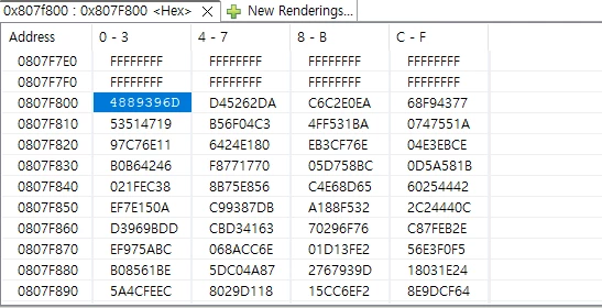

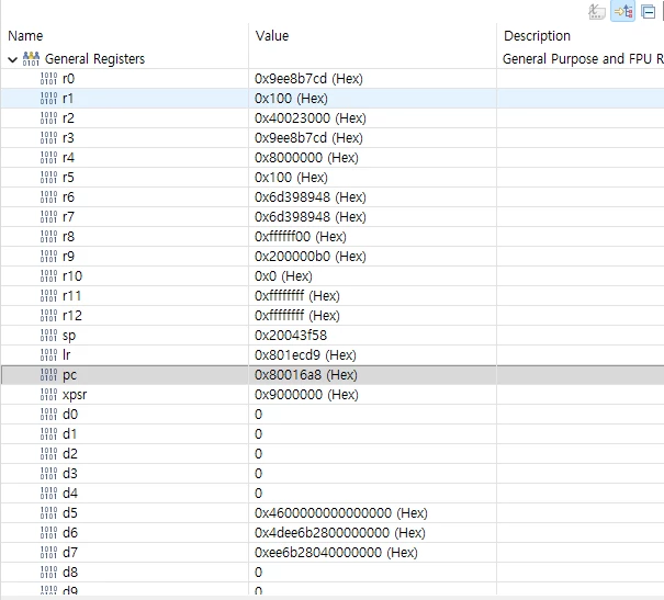

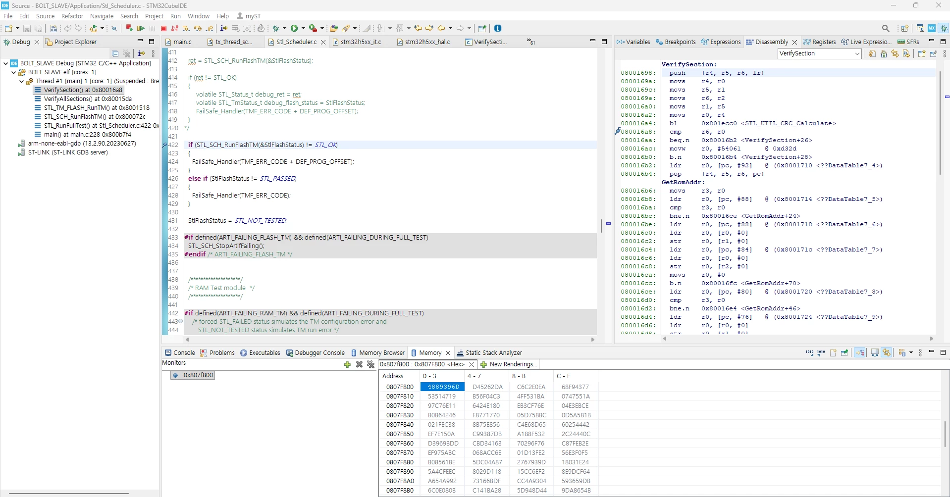

I am developing a firmware using the STM32H523VET6 MCU. I downloaded and am applying the sample below, but the `StlFlashStatus` value returned by the `STL_SCH_RunFlashTM(&StlFlashStatus)` function inside the `STL_RunFullTest()` function is `STL_FAILED`. I would like to know the reason for this. I understand that this example file supports all STM32H5 models; is that not the case?​
Post-Build Steps Command: echo "\"STM32_Programmer_CLI.exe\" -sl \"%CD%\${BuildArtifactFileName}\" 0x08000000 0x08080000 0x400" > call_prg.bat && cmd /c call_prg.bat && arm-none-eabi-objcopy -O binary --gap-fill 0xFF "${BuildArtifactFileBaseName}.elf" "${BuildArtifactFileBaseName}.bin"
Sample : stm32cubeexpansion-x-cube-classb-h5-v4.0.0.zip

Hello bupark007,
Thank you for your reply.
When the first CRC calculated by the STL (the value in R0) is incorrect, this is typically due to a mismatch in the library configuration.
To ensure that everything is set up correctly for your device, could you please confirm whether the configuration macros in the stl_user_param_template.c file have been properly set?
You should have something similar to the following in this file:
#define STL_ROM_NO_TZ_START_ADDR (0x08000000UL) /* customizable */ /* No TZ */
#if defined (STM32H563xx)
#define STL_ROM_TZ_S_START_ADDR (0x0C000000UL) /* customizable */ /* TZ, Secure Flash */
#define STL_ROM_TZ_NS_START_ADDR (0x08100000UL) /* customizable */ /* TZ, Non-Secure Flash */
#define STL_ROM_NO_TZ_END_ADDR (0x081FFFFFUL) /* customizable */ /* no TZ: 2 Mbytes */
#define STL_ROM_TZ_S_END_ADDR (0x0C0FFFFFUL) /* customizable */ /* TZ, Secure: 1 Mbytes */
#define STL_ROM_TZ_NS_END_ADDR (0x081FFFFFUL) /* customizable */ /* TZ, Non-Secure: 1 Mbytes */
/* For all devices not supporting TrustZone, addresses related to TrustZone should be initialized to NULL value */
#elif defined (STM32H503xx)
#define STL_ROM_NO_TZ_END_ADDR (0x0801FFFFUL) /* customizable */ /* no TZ: 128 Kbytes */
#define STL_ROM_TZ_S_END_ADDR NULL
#define STL_ROM_TZ_NS_END_ADDR NULL
#define STL_ROM_TZ_S_START_ADDR NULL
#define STL_ROM_TZ_NS_START_ADDR NULL
#else
#define STL_ROM_NO_TZ_END_ADDR (0x0807FFFFUL) /* correct value for STM32H523VET6 */
#endif
Compared to the example, I added:
Then, for GCC, you should adapt the linker file as shown in the example below: (as in STM32H563ZITX_FLASH.ld)
.data :
. = ALIGN(4);
_sdata = .; /* create a global symbol at data start */
*(.data) /* .data sections */
*(.data*) /* .data* sections */
*(.RamFunc) /* .RamFunc sections */
*(.RamFunc*) /* .RamFunc* sections */
. = ALIGN(4);
_edata = .; /* define a global symbol at data end */
_edata_load = LOADADDR(.data) + SIZEOF(.data) - 4; /* address of the last word of this section, which is also the last word in Flash */
} >RAM AT> FLASH
As described above, _edata_load defines the address of the last word in that section. You should add a similar definition to the last Flash section in your linker file in order to get the last address of your ROM code.
Of course, this piece of code should remain in your file, most likely in Stl_scheduler.c:
/* For GCC (STM32CubeIDE): */
#if (defined (__GNUC__) && !defined (__CC_ARM) && !defined (__ARMCC_VERSION) )
/* symbol _edata_load is defined in linker-script. Its address is the last word of the used part of flash memory. */
extern void *_edata_load;
#define TEST_ROM_END_ADDR ( (uint32_t)&_edata_load + 3)
#endif /* __GNUC__ */
Could you please verify whether these conditions are satisfied?

So, if you go to this address, you should find something similar to the screenshot below.
dump memory at address 0x807f800
If the CRC table is present, we can then compare the CRC calculated by the STL with the CRC stored in Flash.
To do this, set a breakpoint in the VerifySection function, after the call to STL_UTIL_CRC_Calculate, you will find the following instruction:
CMP R6, R0
like:
Here, R6 represents the CRC calculated by STM32CubeProgrammer, while R0 represents the CRC calculated by the STL.
Please note that, in some cases, STM32CubeProgrammer may fail to correctly calculate the last CRC value when the image size is not a multiple of 1024 bytes. For this reason, in the example, TEST_ROM_END_ADDR is defined as follows:

Hello, thank you for the quick reply.
I am using the "STM32CubeIDE" tool and the "arm-none-eabi-gcc" compiler.
I verified the CRC value at address 0x0807F800 as shown in the figure below.
Additionally, after calling STL_UTIL_CRC_Calculate in the verifySection function and setting the endpoint, I confirmed that the R6 and R0 values ​​are different.
How can I verify why the R0 value is different?
R6 comes out as 0x6d398948, matching the address value of 0x0807F800, while R0 comes out as 0x9ee8b7cd.
