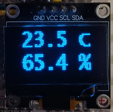

Hi!
I'm trying to make a LCD screen work, but without success.
I found this library:
https://github.com/STMicroelectronics/stm32-ssd1315
But I can'd find more documentation with examples (how to initialize).
Can you give me a "wire"? Now I'm using a ssd1306 library, but all the even rows (of my screen) are empty

You'll probably have to commit resources to debug it.
Double size with gaps suggests and issue with the rasters/display buffer, and perhaps a multiplier
Perhaps look here, port this, or perhaps the AdaFruit drivers
https://tinusaur.org/2019/04/29/updated-ssd1306xled-library-fixes-compatibility-ssd1315/
I've worked with the SSD1306 (0.96") / SSD1309 (2.42") variant.

Check COM setting via Command 0xDA
Check Zoom mode via Command 0xD6

Hello @cyberpex,
You can refer to the BLE_p2pServer application available in STM32CubeWB. This application uses the SSD1315 library, which may assist you in your implementation.
