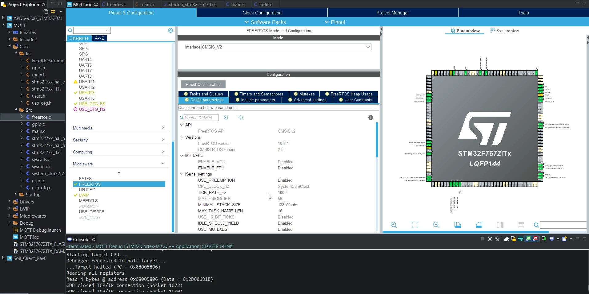

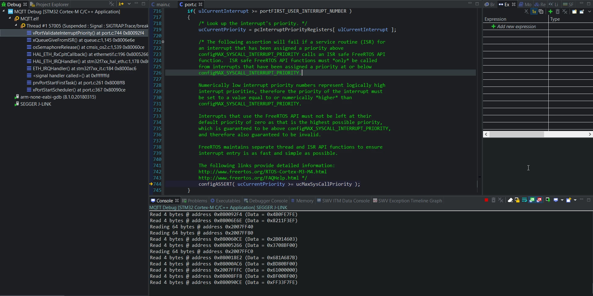

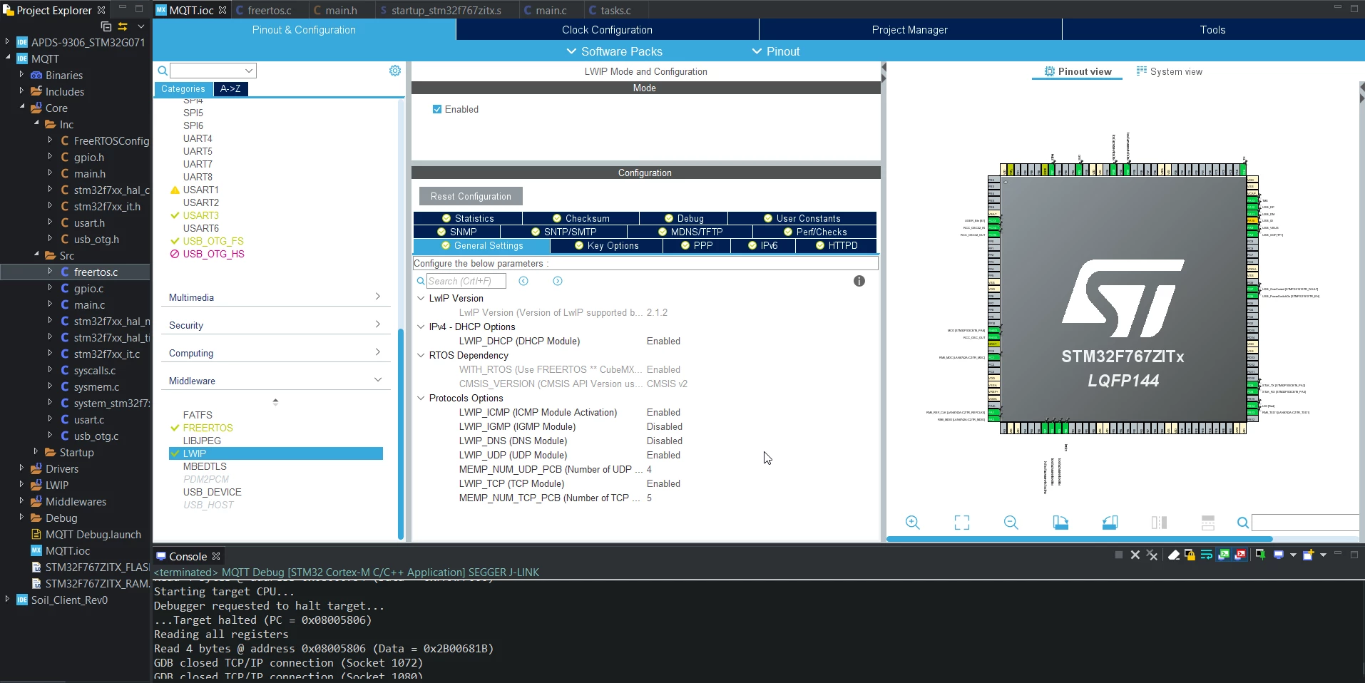

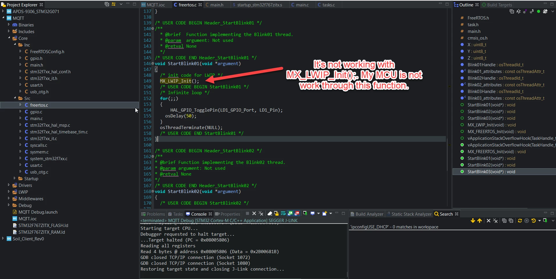

Hello every one;
I would like to use lwip with RTOS( In DHCP Mode ). I try use lwip without RTOS ( In DHCP Mode ). It's work but I use lwip with RTOS is not work. I confuse to set priority (NVIC according to FREE RTOS ) lwip with RTOS. Could you please advice me?

Hello every one;
I could fix this problem. I must to set priority lower FREE RTOS .
