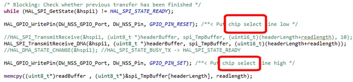

How to use 'HAL_SPI_TransmitReceive_DMA' & 'HAL_SPI_Transmit_DMA' for spi, but error in 'devID'
i'm using 'HAL_SPI_TransmitReceive_DMA' , but error in 'devid'
'HAL_SPI_TransmitReceive_DMA'  -> The path to use this function is
If I use the commented 'HAL_SPI_TransmitReceive' function, the 'devID' value is 0xdeca0310 (normal value)
If you use the 'HAL_SPI_TransmitReceive_DMA' function, the 'devID' value comes out as 0x0(error).
DMA settings are as follows.
I must solve this problem/
Let me know if there is any information you need to solve the problem.

HAL_SPI_TransmitReceive_DMA starts a transmission which runs in the background. You need to wait for it to complete before you can pull up the CS pin and read the data.

I'm sorry, but what CS pin are you talking about?
"CS" = "Chip Select"
Feb 21, 2024 9:26 AM UTC
Wait DMA to finish before you set NSS(CS) pin.
