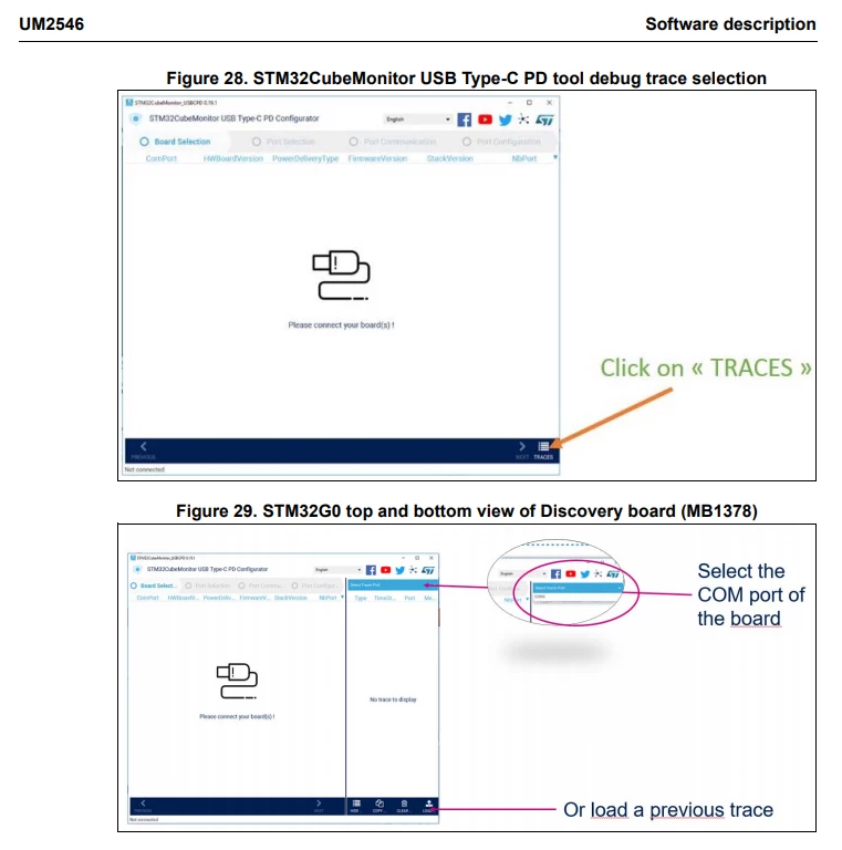

I advice you to have a look to following documents 'UM2552' (and §3.6.4)
In the projects we deliver, this switch "_TRACE" willl allow to see communications between 2 boards.

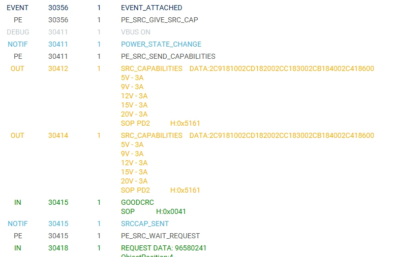

Trace is done through USART pins connected to ST link. You should use Cubemonitor-UCPD and use the functionality described in the following image:
You should see logs like this:
