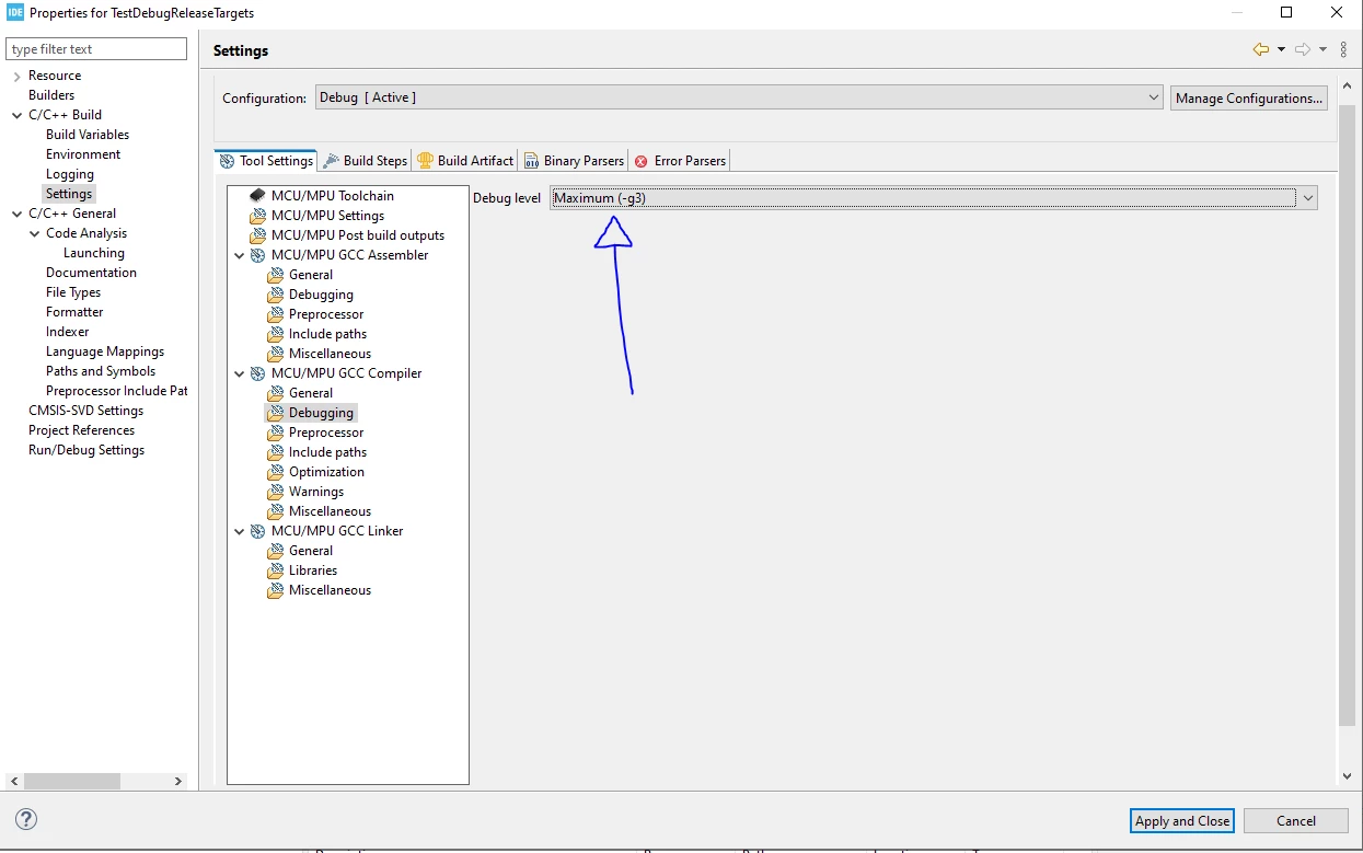

Hi All,
By mistake the default debug target got deleted and our development/testing target got created using the release target. I was looking at what are the exact options in which the debug and release target differs so I can create the debug target again. I tried to create the debug target from the "create new configuration" menu using the default debug target there, but it does not seems to work. The current development target have already lots of updates for our custom project so I rather not create a new project but instead update it with the debug configurations to be able to step in the debug mode, also I think this post might be useful for other people if we get the answer.

Well I found it to be a setting in the project menu... if anyone was wondering.

Usually optimisation also should be changed accordingly
