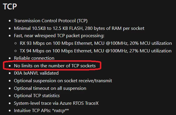

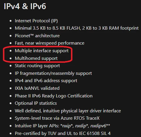

I am using the stm32h563 processor in my project. I made a TCP Server application using the ethernet connections of this processor and I was able to run it as I wanted. But I saw that it could not connect to another client over the same IP address without breaking the connection with one client. Even though I set the NX_MAX_PHYSICAL_INTERFACES defined value to two, there was no change. Also, in the files I shared, it is said that we can make a tcp server and 2 tcp client connections and open a separate socket for each (1).

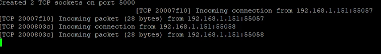

I've prepared a small template file app_netxduo.c from which I was able to send data with multiple clients on the same IP address and port.
Find attached the template File and confirm if this what you need to do.
Regards

Hello @STea ,
Yes, this is exactly what I wanted. Thank you very much for your help.
