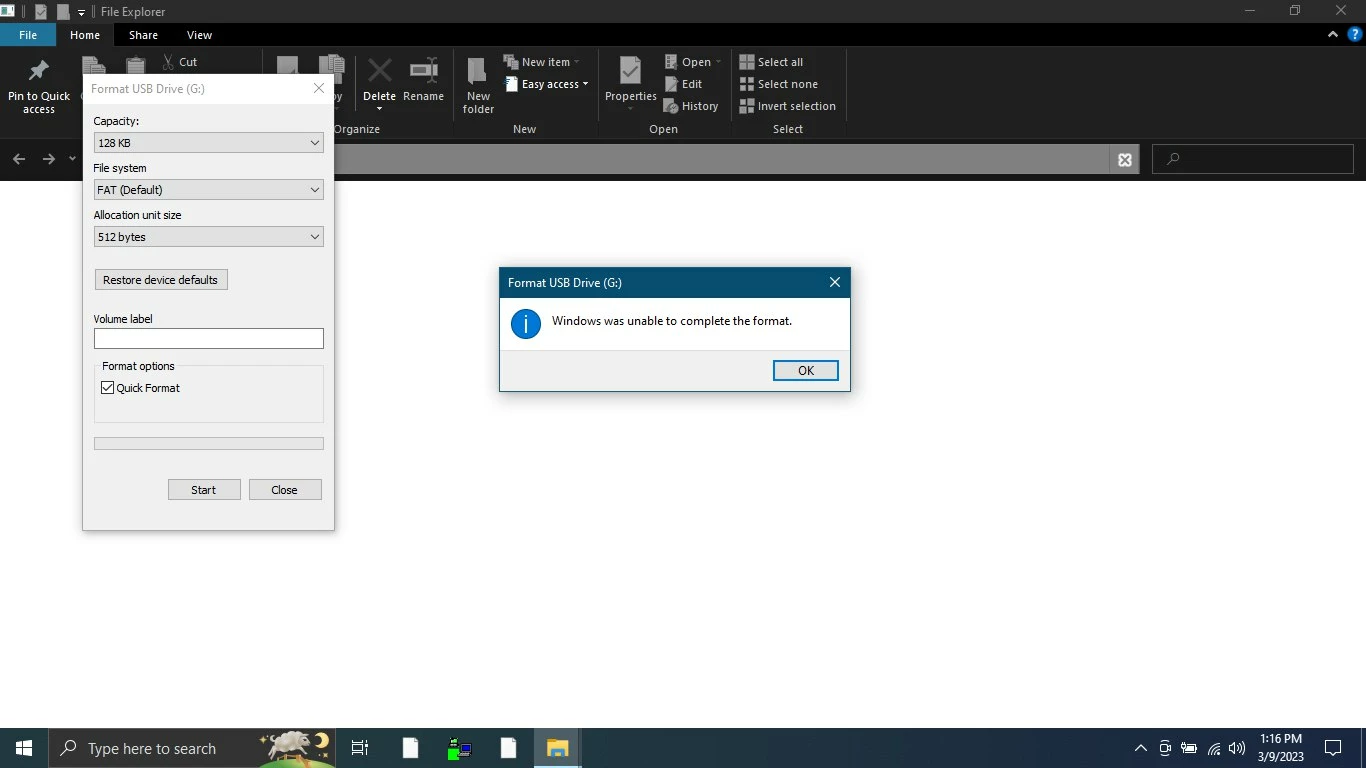

ADevg.1
ADevg.1Author
Mar 9, 2023 7:57 AM UTC
I'm allocate 128KB Flash block size, but file not created and unable to complete the format. https://github.com/ankitdevganiya13/STM32_USB_MSC_FATFS/tree/master

Haithem Rahmani
Apr 4, 2023 10:15 AM UTC
Hi @ADevg.1​
IIRC, you are configuring the STM32 as an USB storage device and want to write data using the windows machine on the internal flash of the STM32?
is this correct?
