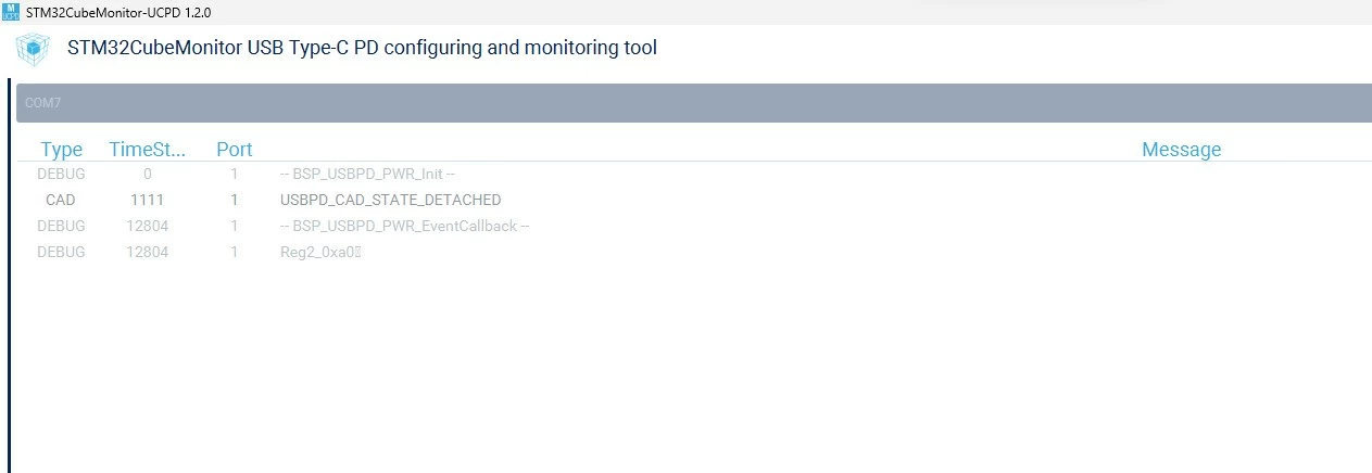

How to setup USB-C PD Source using NUCLEO-G491RE with X-NUCLEO-SRC1M1 Extension?
I am a newcomer to the ST world- I am working with VW of America and UTK on a senior design project.
I am attempting to setup a USB-C PD source application using a NUCLEO-G491RE Connected to a SRC1M1 extension board. I have tried directly loading the src1M1 example project in x-cube-tcpp (nucleo-g474re/applications/USB_PD/SRC1M1_Source) and following this guide on the wiki. For the wiki project, I applied the correct BSP and adjusted the .extsettings file to point to the correct BSP.
When monitoring stcubemonitor-UCPD, neither stack seems to be responding in the desired manner, and no contract is negotiated.
What further steps should I be taking to set up my USB-C application? I know this is a desired function from ST, so it should be pretty simple.

Have you enabled the embedded debug tracer as described here ?
You can also compare the project available on github for NUCLEO-G474RE, it should be similar.
Does something live in the trace window on the right in STM32CubeMonitor-UCPD, following this wiki ?
If yes, can you share the content ?

The following is the trace that occurs with my project which followed this wiki.
If I load the src1m1 project from x-cube-tcpp by selecting the ioc file in STM32CubeIDE, building it, and running it, I do not get anything in the trace.0693W00000YAOXKQA5.jpg

During the trace above I did connect a USB-C capable device.

When I load that program I do not see my device available on ucpd monitor and I do not see anything on any trace - and there is nothing happening when I plug in the device.
I did identify a potential issue. I connected a dc power supply to cn3, but I connected it to the ground side of the header for a few seconds. I do not believe my supply dissipated any power into the device, but hardware issues are a potential culprit.

You should check for the messages : DEBUG -- BSP_USBPD
Because they are linked to the nucleo-src1m1 shield, and the BSP that controls the TCPP02 which enables the VBUS.
