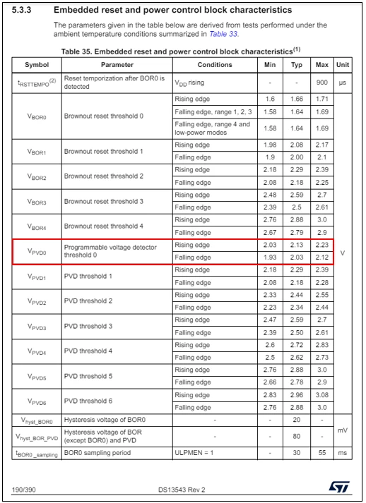

How to setup PVD STM32U5xx with system VDD running at 1.85v
As mentioned in the title, the custom board system VDD is 1.85 volt, I wonder if there are anyways that I can setup the PVD to work with such voltage. I follow the example and I only get the interrupt at startup but then cutting power off, obviously I see no other interrupt.
 HAL_NVIC_SetPriority(PVD_PVM_IRQn, 0, 0);
 HAL_NVIC_EnableIRQ(PVD_PVM_IRQn);
 PWR_PVDTypeDef ConfigPVD;
 ConfigPVD.Mode = PWR_PVD_MODE_IT_RISING_FALLING;
 ConfigPVD.PVDLevel = PWR_PVDLEVEL_0;
 HAL_PWR_ConfigPVD(&ConfigPVD);
 HAL_PWR_EnablePVD();

Hello @VPHAM.1,
As told by @Dor_RH you can not use PVD with a VDD of 1,85V, but you can use a comparator instead.
Use a voltage divider from VDD and compare it with VREFINT(1.2V) or VREFINT_DIVX .
Choose the voltage divider resistors to set you threshold.
Then program an interrupt from the comparator rising or falling(depending on your configuration) edge.

Hello @VPHAM.1,
To meet your 1.85 volt requirement, you'll need to choose the nearest PVD threshold level available on STM32 microcontrollers. For exact threshold values, please refer to the Datasheet - STM32U5Axxx
In your case, exact correspondence with 1.85V is not available, so opt for the next higher threshold.
That's why could you try to modify:
 ConfigPVD.Mode = PWR_PVD_MODE_IT_FALLING;
