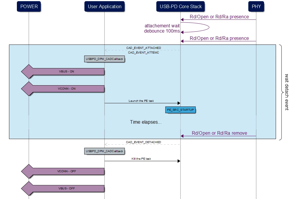

Hello, what is the voltages you see on CC lines? I suggest you also to refer on our User Manual UM2552 and check the source connection procedure described in Figure11:
And also remind that you can add your own traces, also described in the same document (3.6.4 TRACE system):
