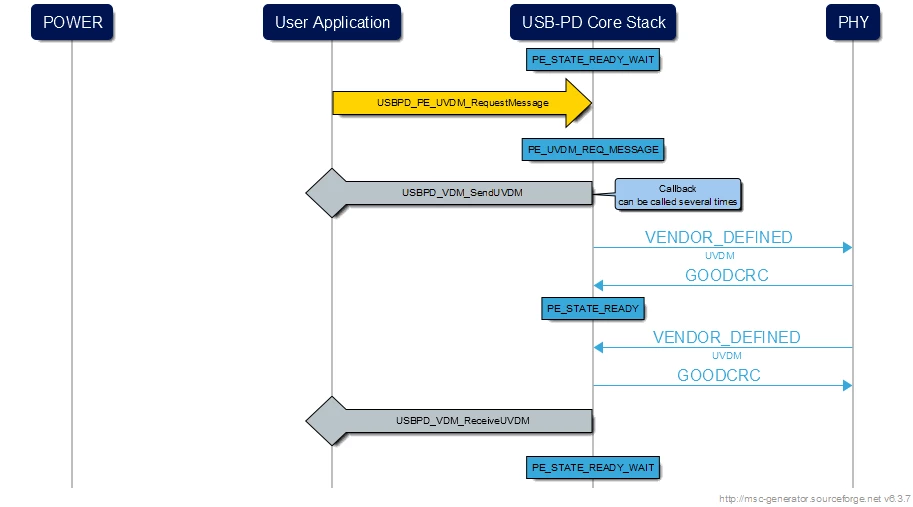

How to send a Unstructured VDM in stm32g0?
I found senduvdm callback in usbpd_vdm_user,c "USBPD_VDM_SendUVDM(uint8_t PortNum, USBPD_UVDMHeader_TypeDef *pUVDM_Header, uint8_t *pNbData, uint32_t *pVDO)";
and just found one interface,USBPD_StatusTypeDef USBPD_PE_UVDM_RequestMessage (uint8_t PortNum, USBPD_SOPType_TypeDef SOPType ), which can't set my data,and how to send an uvdm package after call a "send interface" ?

Yohann M.Best answer
Oct 22, 2019 7:51 AM UTC
Hello
Here is the associated Message Sequence Chart you can refer to:0690X00000AqfEwQAJ.png
To fill data, you have to complete the following callbacks functions in usbpd_vdm_user.c file:
 * @brief VDM Send Unstructured message callback
 * @param PortNum current port number
 * @param pUVDM_Header Pointer on UVDM header based on @ref USBPD_UVDMHeader_TypeDef
 * @param pNbData Pointer of number of VDO to send
 * @param pVDO Pointer of VDO to send
 * @retval None
static void USBPD_VDM_SendUVDM(uint8_t PortNum, USBPD_UVDMHeader_TypeDef *pUVDM_Header, uint8_t *pNbData, uint32_t *pVDO)
/* USER CODE BEGIN USBPD_VDM_SendUVDM */
/* USER CODE END USBPD_VDM_SendUVDM */

Visitor II
Jan 22, 2025 5:47 AM UTC
I have a strange problem sending UVDMs on G0B1RE.
I connected it with a G474RE using wires. The whole negotiation works. I got an explicit contract. Connecting the G474RE to a laptop charger does also work fine. I can set voltages and respond to Discover Identity VDMs from the laptop supply.
Now, I wanted to use UVDMS for "user defined features". The G474RE already sends a UVDM, the G01B1RE successfully receives it. Then I wanted to send another UVDM as resone from the G01B1RE.
I'm waiting for "USBPD_NOTIFY_STATE_SRC_READY" then call USBPD_PE_UVDM_RequestMessage(PortNum,USBPD_SOPTYPE_SOP);
The USBPD_VDM_SendUVDM is called. I can see the action in the log
39 PE 46601 0 PE_STATE_READY
40 NOTIF 46603 0 STATE_SRC_READY
41 PE 46603 0 PE_UVDM_REQ_MESSAGE
42 IN 46624 0 SOP s:002 H:0x0641 (id:3, DR:UFP, PR:SNK) GOODCRC
43 PE 46624 0 PE_STATE_READY
But no message is sent - WHY ???
