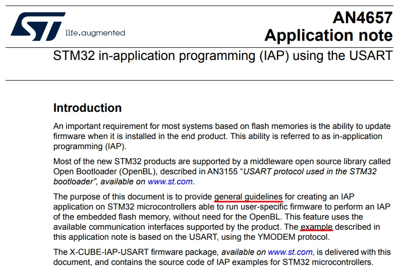

I would like to in-live upgrade firmware of STM32F407 through USART1, that means  in-application program(IAP) . If I remember right, there need a trigger signal from key meanwhile NRST is low.
My question is that the Key signal could be connected to any GPIO I/O of STM32F407 except those dedicated pin, right?  Is there special point to care about selection of  Key I/O pin?

IAP is more related to the application note: AN4657 "STM32 in-application programming (IAP) using the USART" and the X Cube package: X-CUBE-IAP-USART.
So in the firmware check what was implemented for that "Key" and find how it could be changed.

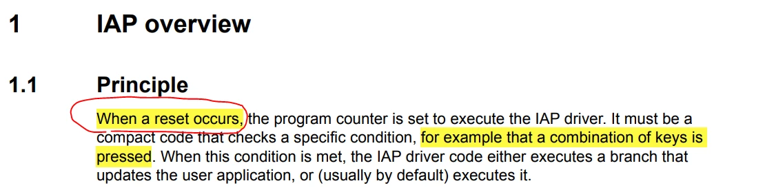

I checked AN4657, and want to know if push-button must be pressed all the time until user application have been download to flash memory, or just pressed then release which generate time-limited negative pulse?

It seems highly unlikely that the user would have to keep the button pressed for the entire time - that would be a nightmare UX!
But the source code is available - take a look!
Or build it and try it out.
You can modify it as required ...
PS:

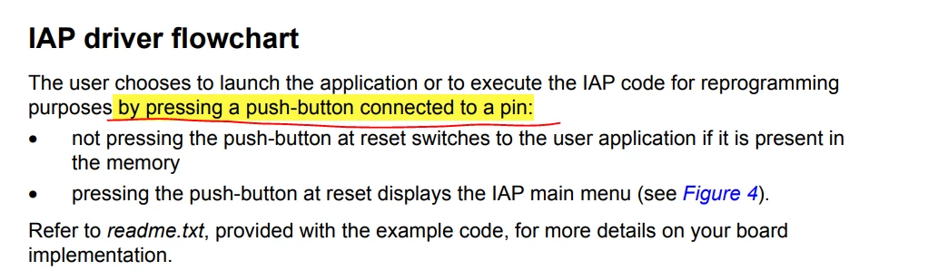

Look at the flowchart @mƎALLEm shared:
The switch is only used to decide whether to 'Jump to user program' or to 'Initialise IAP'.
Once that decision has been made, the key can be released.
Again, the code presented is just an example - you can do whatever suits in your own implementation...

So, the pin for key could be  any GPIO I/O of STM32F407 only if the input of this pin is judged in below switch ,right?
Suddenly I notice that reset must occur at the same time with the Key signal, so the reset brought by NRST pin also is not kept pressed all the time, right?

You're causing a Reset, so a brief press of the reset button, then in the Reset_Handler path you're checking a GPIO state to decide what code to execute. Any available GPIO that's free will suit. Avoid debug pins.
