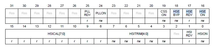

based on your advice "are you able to connect using SWD to your board running in bootloader (connect to running target) and read out PLL setting done by system DFU bootloader.", did some tests and here is what I retrieved :
* On the discovery, working DFU bootloader over USB, register RCC_CR reads 0x030b5783. Not sure how and why it detects an HSE as crystal is not mounted ...
* On my board, DFU bootloader running allow for UART bootload ! It confirms the bootloader is working but most probably does not detect the clock correctly.
* On my board, DFU bootloader running but no working USB, RCC_CR is 0x03004b83. Meaning that HSE is off as well as the bypass. Probably the bootloader does not detect a crystal and continues on HSI instead.
* On my board, if I change RCC_CR from 0x03004b83 to 0x01054b83 in the debugger (setting HSE on, bypass on), it ends up with 0x03074b83 (meaning the HSE turns to ready). It confirms that when bypass is enabled the HSE is correctly detected and set to ready.
* On my board, resetting the chip does not fix the issue, so it is not a race condition on external clock power on.
So if my analysis is correct the bootloader indeed does not enable USB because it runs on HSI instead of HSE bypass (not supported ?). Can you confirm my analysis ? Any way of forcing it to HSE with bypass or it is 100% boot rom without possible forced configuration ?

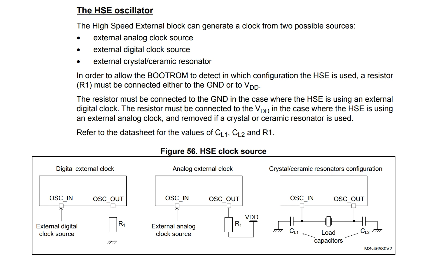

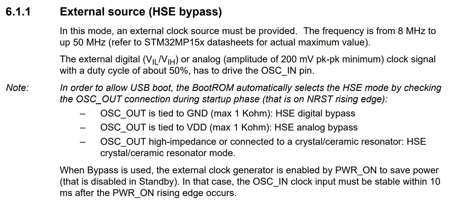

My company had a similar issue when working with STM32MP1 series.
Regarding STM32MP153 advanced Arm<Sup>®</Sup>-based 32-bit MPUs - Reference manual point 10.4.2 HSE Oscillator.
Our hypothesis was that ROM Code failed to configure HSE Bypass because a 1K Ohm impedance was required to be connected to Vdd or GND in PH1-OSC_OUT pin.
This information is also specified in Getting started with STM32MP151, STM32MP153 and STM32MP157 line hardware development - Application note point 6.1.1

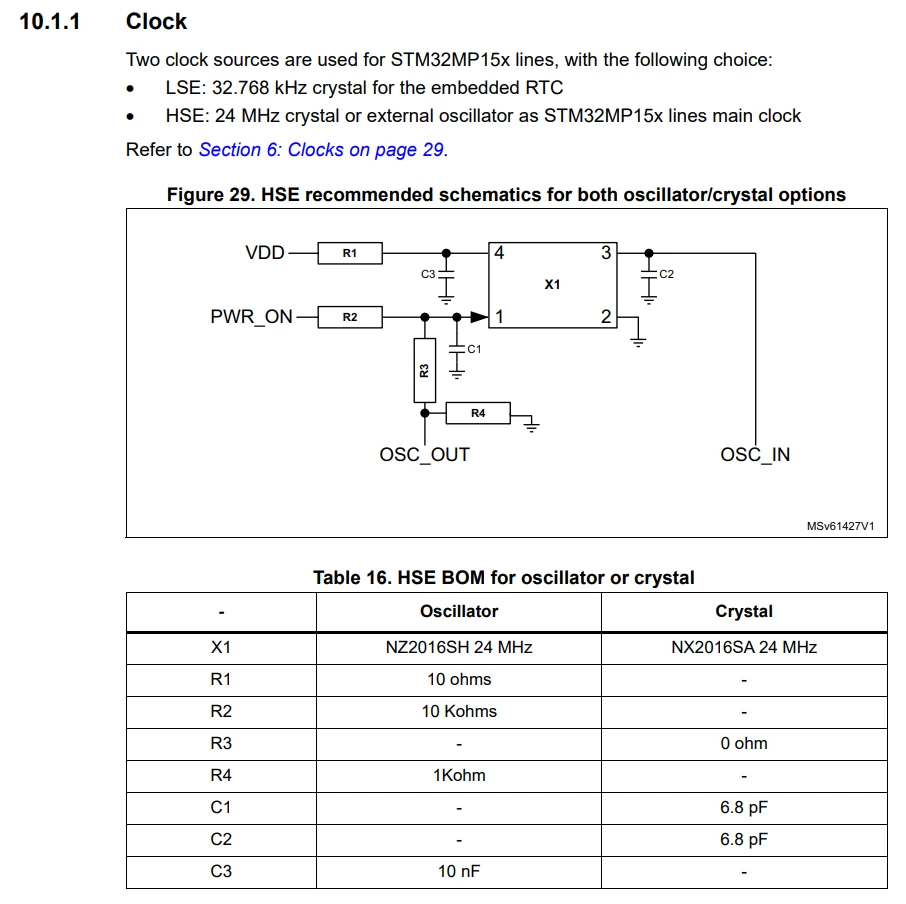

There is another key point. It may be mandatory to give the processor the capability to turn on/off HSE clock.
At point 10.1.1 of the same document (related to clock configuration)
I hope this information can save you some quality time.

Aug 14, 2024 3:07 AM UTC
Thanks PS-PabloGS. We had the same problem but on the L151. If it helps anyone else, on the STM32L151 if using an external oscillator (HSE in bypass mode) the bootloader doesn't seem to handle this so you need a pulldown resistor (1k?) or pulldown cap (20pF?) on PH1 OSC_OUT. I think the L151 bootloader uses HSE in analog mode, expecting to see a crystal on both pins, so adding the pulldown on OSC_OUT should allow it to use an external oscillator only connected to OSC_IN without bypass enabled and it should detect the correct frequency.
