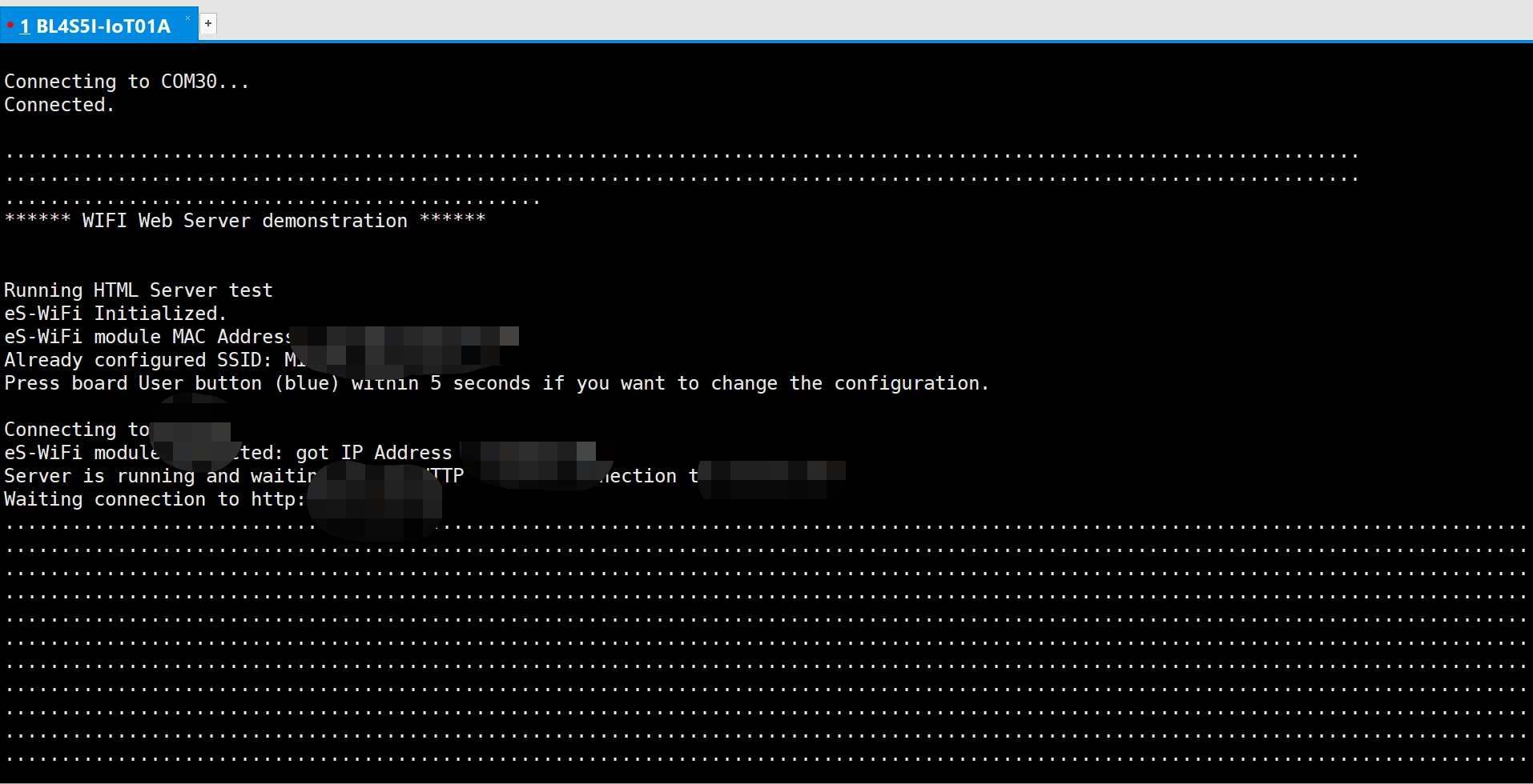

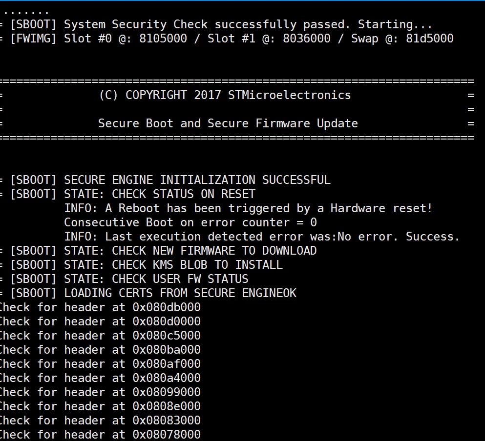

Hello, I'm exploring a new STM32L4S Discovery kit IoT node. After attemped to connect AWS but failed, the original Web server demo FW was erased. I appreciate your guidance regarding:
  1. How to restore the demo FW?
  2. Where can I get some basic CubeIDE examples for B-L4S5I-IOT01A?
Thanks in advance,
0693W00000Y7AP6QAN.pngpic1: web demo fw good
0693W00000Y7AMhQAN.pngpic: web demo fw broken

Hello @BS.Sun​ ,
Maybe you are looking for the working example available in the STM32Cube L4 FW package:
\STM32Cube_FW_L4_V1.17.2\Projects\B-L4S5I-IOT01A\Applications\WiFi\
