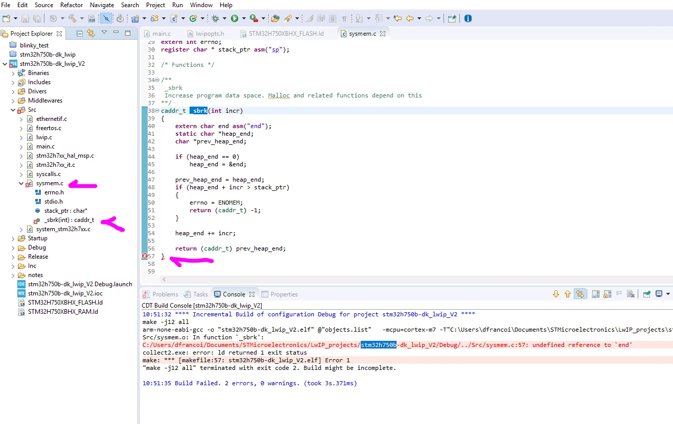

How to resolve an undefined reference to 'end' that is pointing to sysmem.c? C:/Users/dfrancoi/Documents/STMicroelectronics/LwIP_projects/stm32h750b-dk_lwip_V2/Debug/../Src/sysmem.c:57: undefined reference to `end'
  • July 21, 2020
  • 0 replies
  • 1757 views
I am trying to follow "How to create project for STM32H7 with Ethernet and LwIP stack working" posted on May 29, 2020 however I am getting an error undefined reference to end. When I double click the error it points to sysmem.c

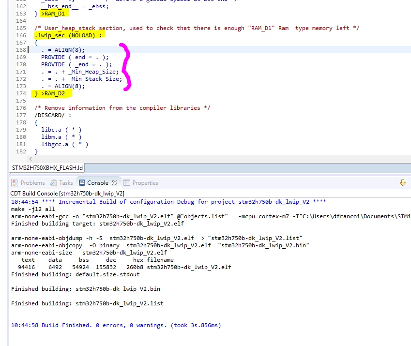

Not being an embedded guy, I isolated the code section that is causing or contributing to the build error as:
  . = ABSOLUTE(0x30040000);
  *(.RxDecripSection)
  . = ABSOLUTE(0x30040060);
  *(.TxDecripSection)
  . = ABSOLUTE(0x30040200);
  *(.RxArraySection)
I made all the changes in the project except, the flash.id original code snip; the program builds OK but, does not work.

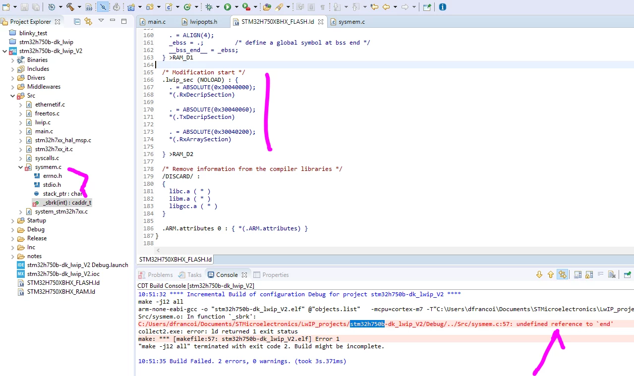

However, when I make all changes, these are the code images showing built errors:
  __bss_start__ = _sbss;
  *(.bss)
  *(.bss*)
  *(COMMON)
  . = ALIGN(4);
  _ebss = .;     /* define a global symbol at bss end */
  __bss_end__ = _ebss;
 } >RAM_D1
 /* Modification start */
 .lwip_sec (NOLOAD) : {
  *(.RxDecripSection)
  *(.TxDecripSection)
  *(.RxArraySection)
 } >RAM_D2
 /* Remove information from the compiler libraries */
 /DISCARD/ :
  libc.a ( * )
  libm.a ( * )
  libgcc.a ( * )
 .ARM.attributes 0 : { *(.ARM.attributes) }
Thanks for your help in advance!
Delton
 Updated with project files.
