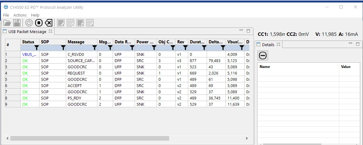

0693W00000KcKOeQAN.pngI still can't make it work.
if (blah == 0) {
 if (!get_contract(0, &rdo))
 continue;
 if (rdo.fix_var.obj_pos > 2) {
 rdo.fix_var.obj_pos--;
 if (!get_pdo(0, rdo.fix_var.obj_pos, &pdo))
 continue;
 rdo.fix_var.max_oper_cur_ma10 = pdo.fix.ma10;
 rdo.fix_var.oper_cur_ma10 = pdo.fix.ma10;
 if (USBPD_PE_Send_Request(0, rdo.b, PD_PDO_TYPE_FIXED) == USBPD_OK)
 blah = 1;
As you can see, I'm reading the existing contract to rdo, then if SRC has another pdo, I'm trying to switch to it. I do monitor CC-lies using Cypress EZ-PD and it doesn't indicate any activity. The flag blah is set.
BMcK
BMcKAuthorBest answer
Mar 14, 2022 5:06 PM UTC
I did make it work. The problem is that the library REQUIRES at least memory for USBPD_SettingsTypeDef Settings, USBPD_ParamsTypeDef Params, but completely lacks any documentation on what they are for and how to use them.
